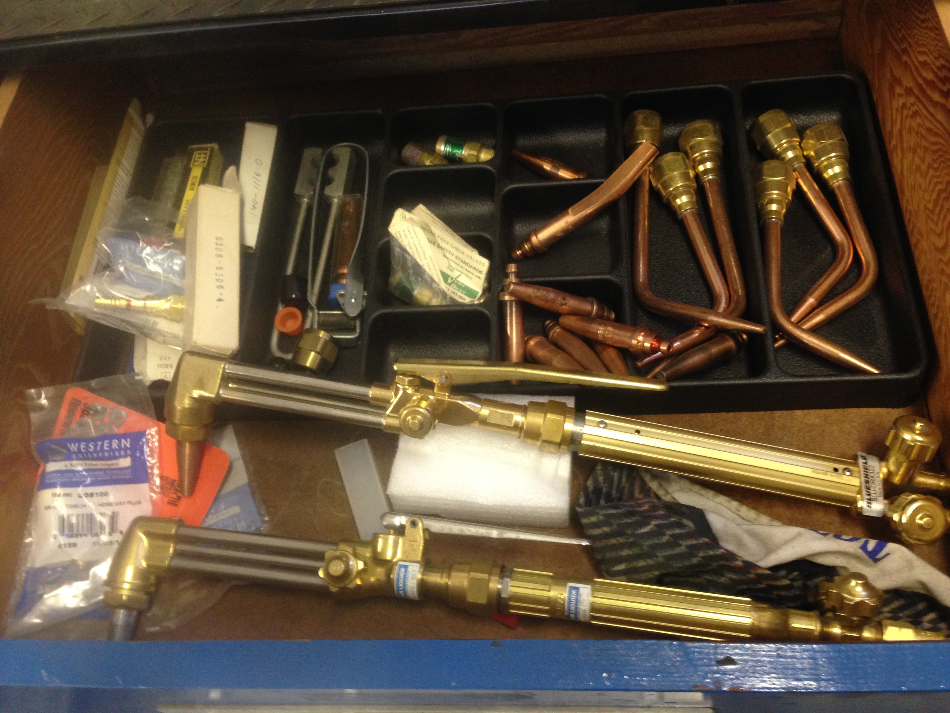

I wouldn’t buy a new set, Pat. I think you would be farther ahead even spending the same amount of money to refurbish the old Victor you have.
I have had two torches rebuilt professionally and in addition to being deemed safe they look like new after they bead blast them.
This is a 30 year old one refurbished about five years ago. It’s branded Air Liquide but I think it is probably made by Concoa Phillips.
You may as well buy a new set of hoses now too. They are very inexpensive.

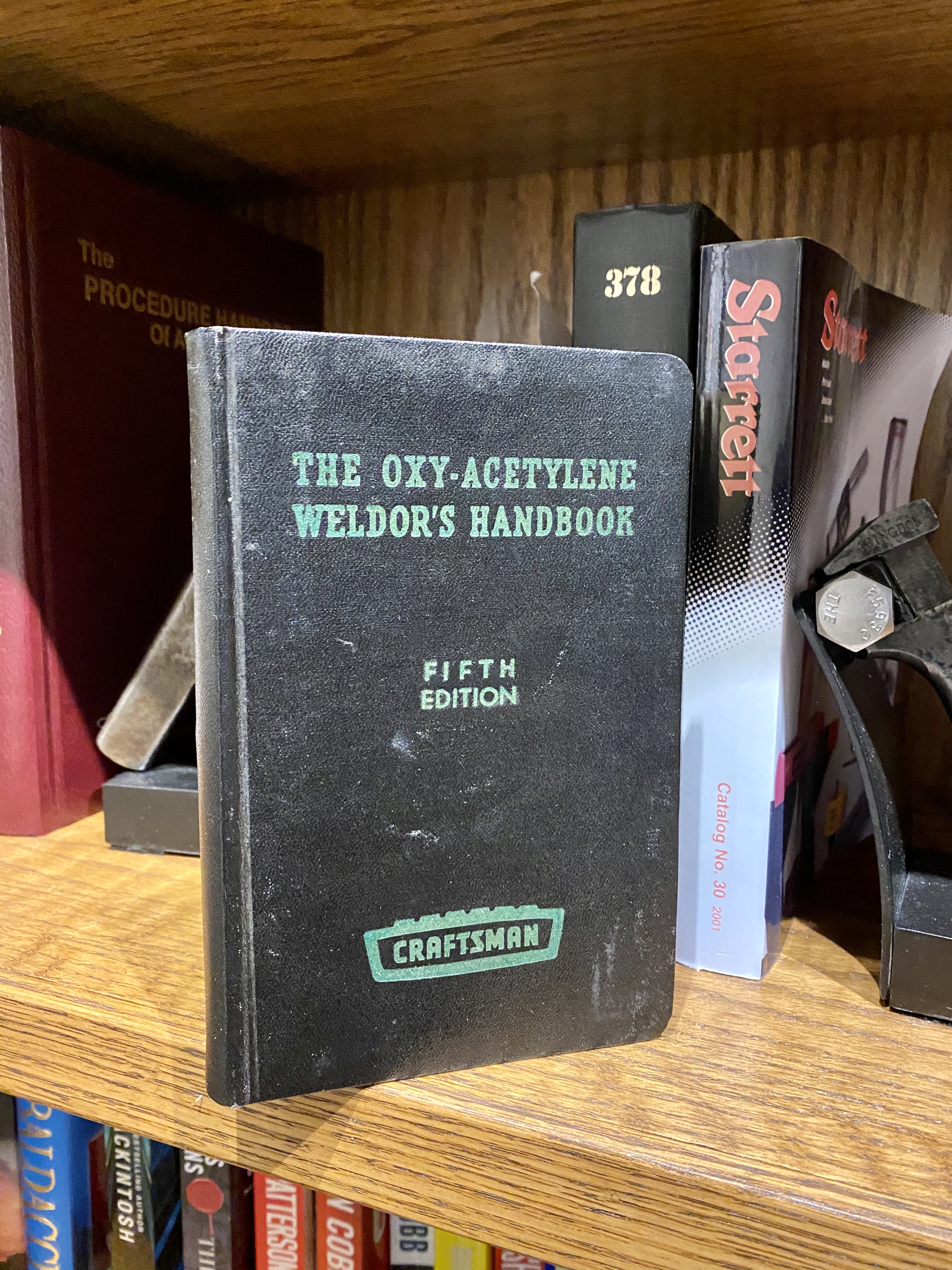

This little book was recommended to me perhaps by someone here.
I am happy to pass along the recommendation. It should be available on eBay or amazon.

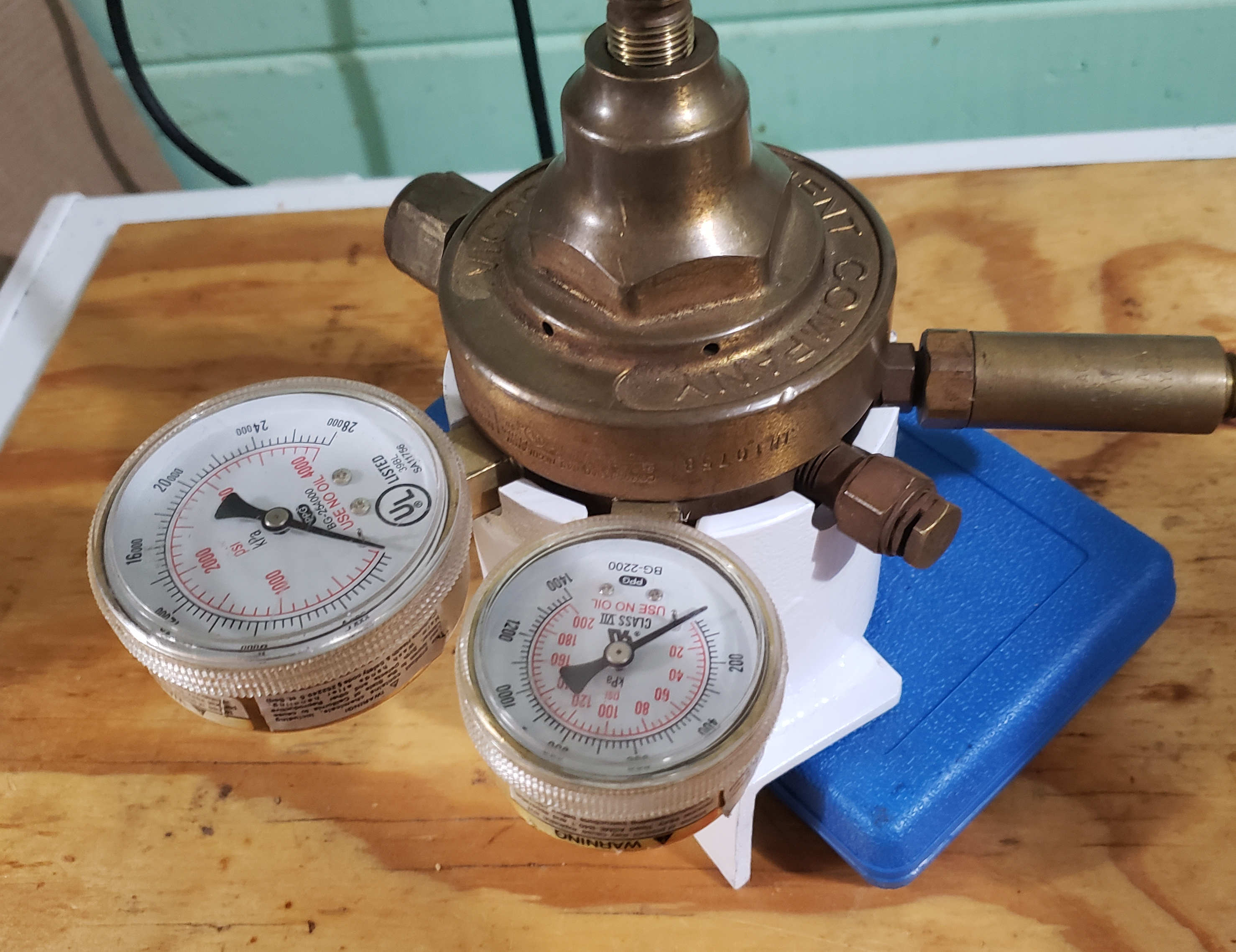

Someone on Welding Web posted this pic today. It’s a fixture for holding a Victor regulator when dismantling. IMG_1020.jpg
It is mounted on a piece of angle iron so that it can be held in a vise.
Yes ordered it thx for the lead. I've never read a word about using a torch, just going with what my Dad taught me.

Someone on Welding Web posted this pic today. It’s a fixture for holding a Victor regulator when dismantling. View attachment 646810
Maybe I need to get back on WW, I got tired of it. That is a nice gizmo. I am sifting through utube stuff now to see what is involved in refurbishing a torch.
