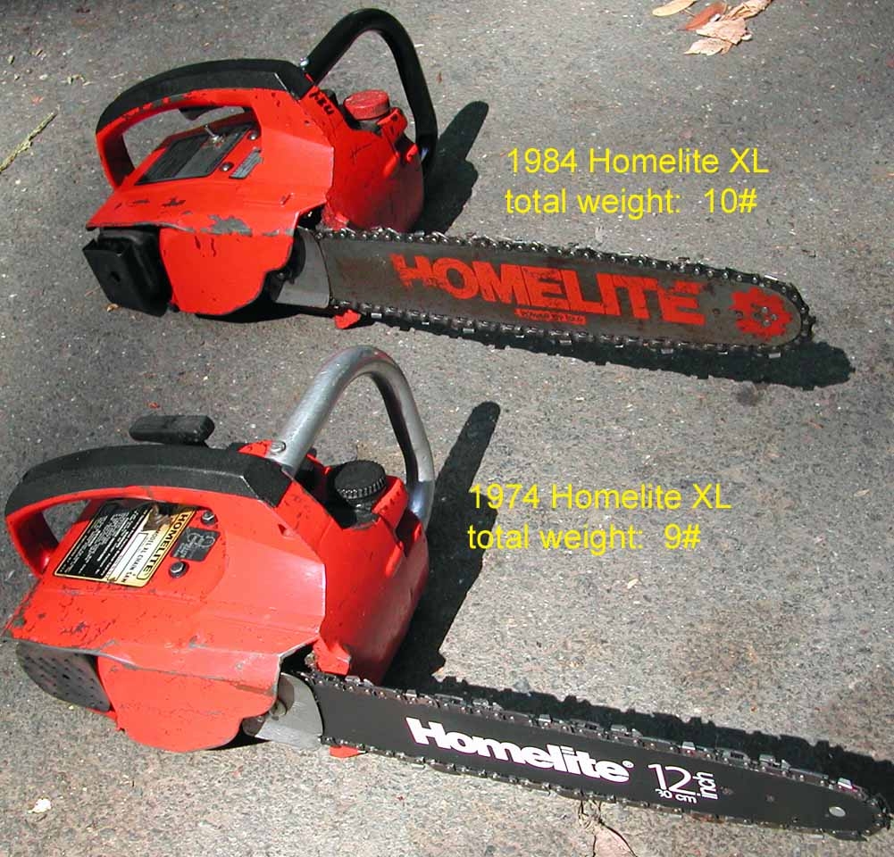

I have had a bunch of those small tophandle Homelite XLs. I do like them, and the parts you are likely to need are available new (carb kit, bars, bearings) or used on eBay. Give it away if bad piston/cyl. I still have one runner left.

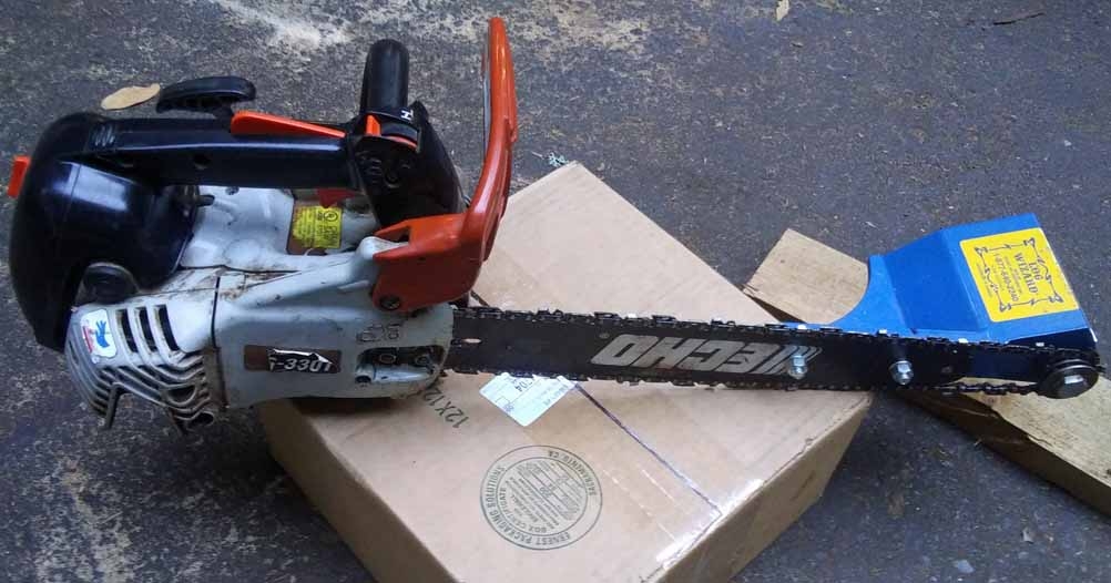

That said, are you considering a LogWizard for this saw? If so, don't use a tophandle; use a small rear handle saw. I installed a LogWizard on an Echo 330T tophandle for a friend, and it is hard on the wrist.

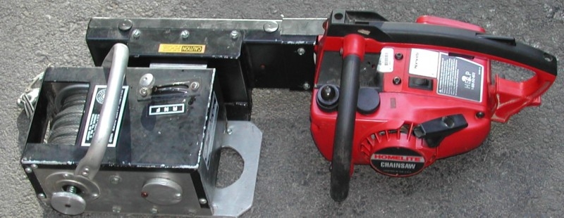

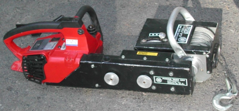

Here is a Homelite XL-powered chainsaw winch I bought years ago. It worked flawlessly hauling building materials up my mountainside. This is the later final vintage of these saws, from the mid-90s. Marketed as "Walt's Game Reel", for big game hunters I gather.
