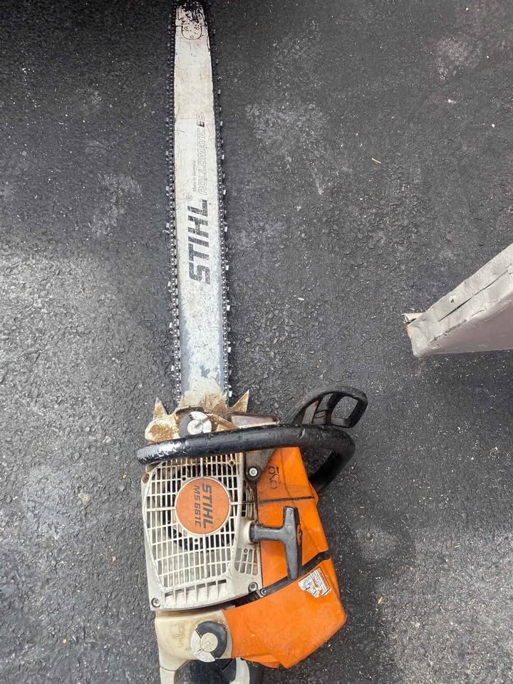

Is $1,000 for a light to moderately used 661 with a 25” bar too much? I think it is, especially since I want a 32” lightweight bar. I offered $900, but he balked.
The price might not be terrible for someone who needs the saw, but with your 500i already in the cupboard, there's much less justification for keeping an MS-66x.
MS-661 = 7.2 hp / 16.5 lb
500i = 6.7 hp / 13.9 lb
At less than 10% difference in horsepower, the MS-661 is too close to the 500i to be anything more than a much heavier emergency backup. If you really need to run a bar that the 500i can't hadle, I'd skip right to the 084/088/MS-88x saws.
The big 84/88/88x's are slow churners, or at least that's how I've always seen them set up. I suspect they were primarily designed for guys running mills, but you can always throw a larger sprocket onto one to bring chain speed up equivalent with an MS-661.
   / Longer bar for Stihl M261 - relative novice. #55
661 with its long stroke of 37mm will shine over a 500 short stroked 34.6mm pretty easily with long bars. This part has nothing to do with HP they do. It's about torque. I'm talking 36" bar etc.
32" even to me is still a short bar. 36" up where I count longer bars starting point.
Plus then the 661 2mm bigger bore on top of that too.
Heck my 71cc 77cc pull 3/8 32" ripping fine and stumping.
