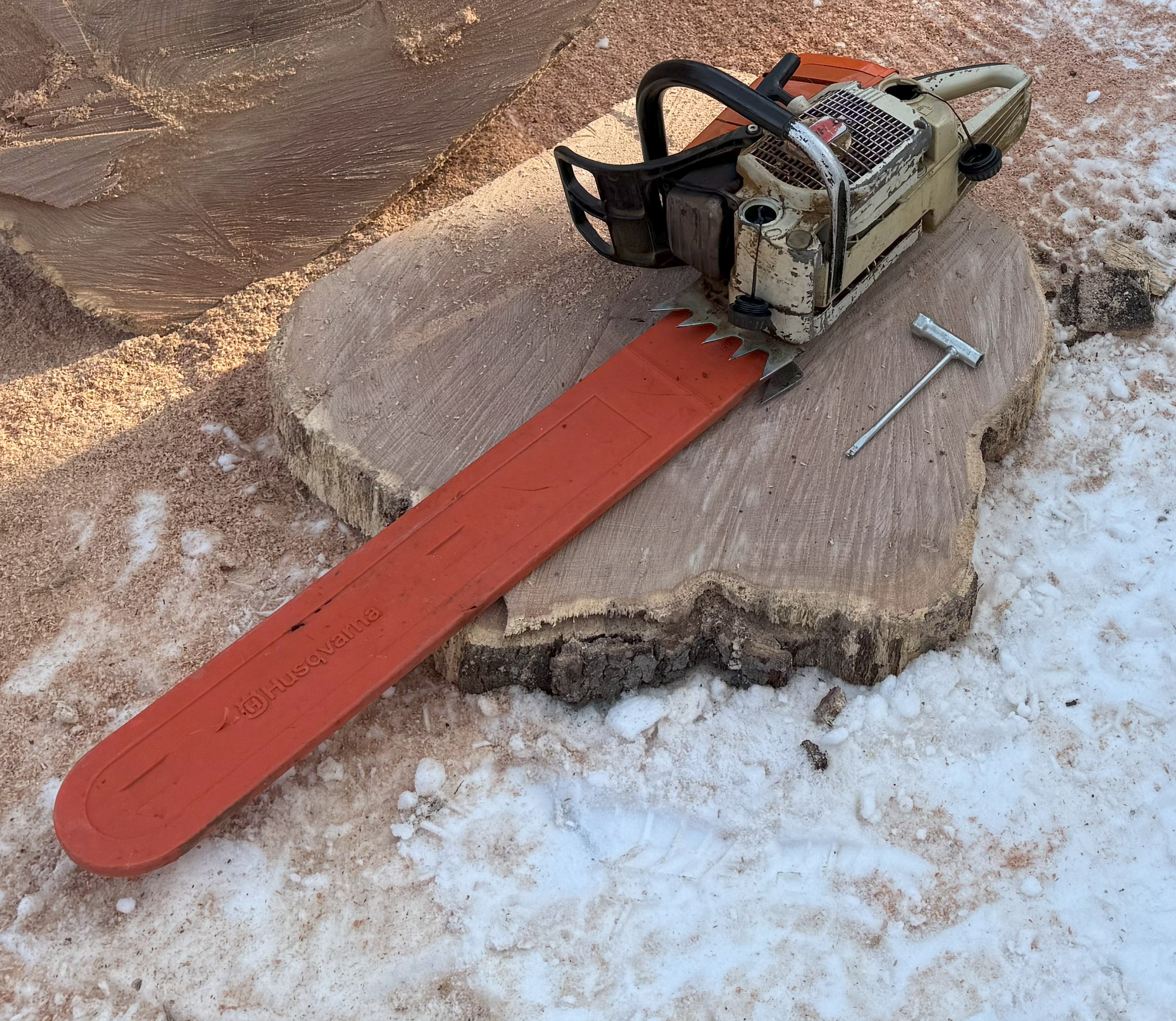

Not untrue, but I think we're miles from this on any reasonably maintained Stihl 180MS-C. They're just not that old.
Some of my saws are nearing 40 years of age, and I still put more hours on them every year than almost any other homeowner / DIY'er. Hell, my 064 is stamped "Made in West Germany". West Germany! West Germany ceased to exist in 1989!
