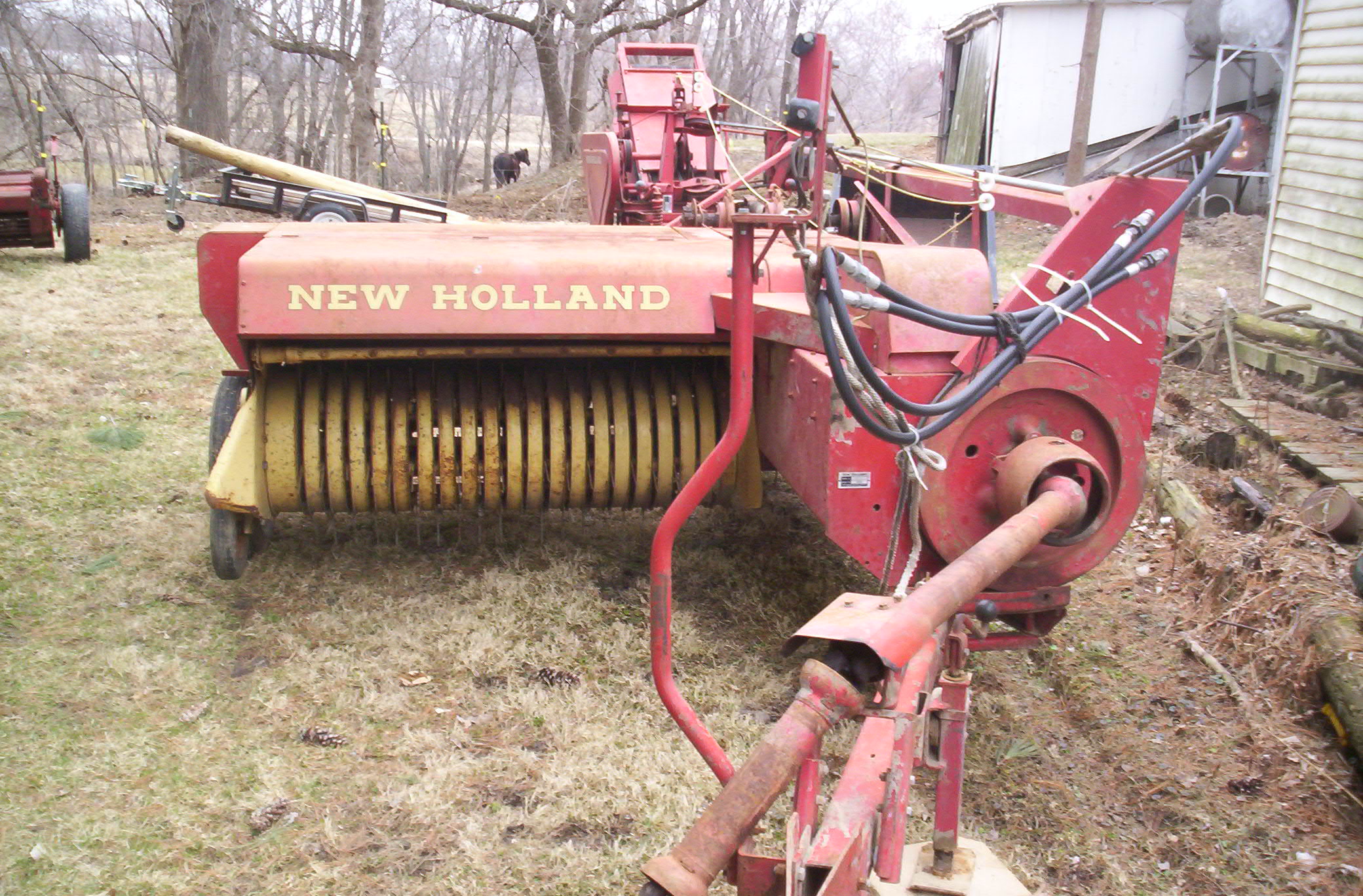

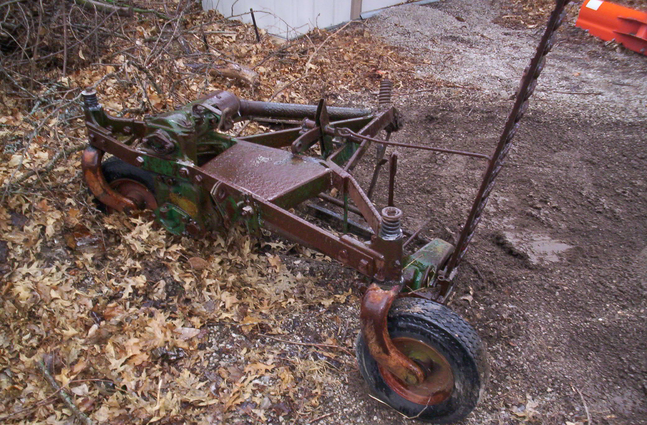

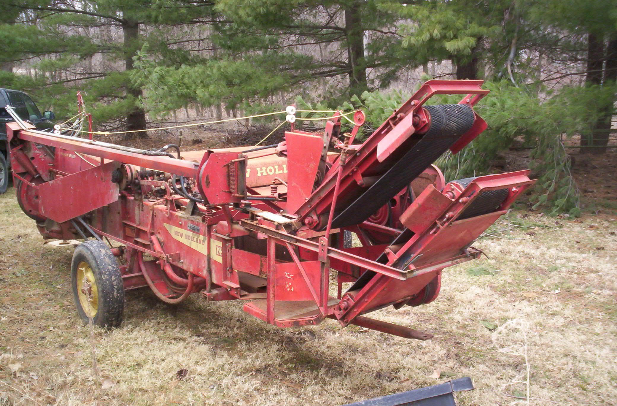

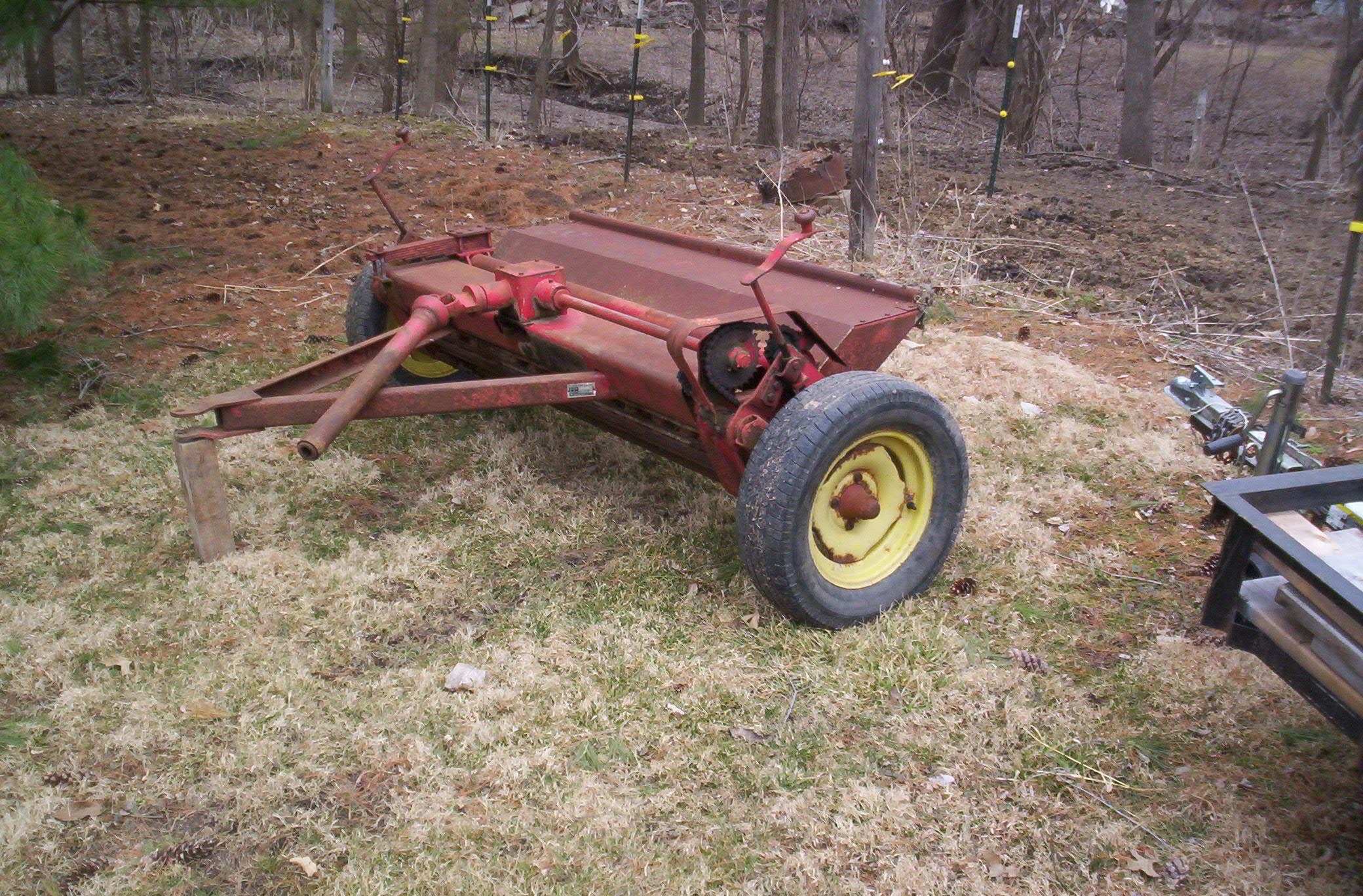

Ok, The Baler Turned Out to be a NH 269 with a 53-A thrower , The Crimper is a NH 402 and the Sickle bar Mower is a 7' Oliver PTO driven.Mower needs a new pitman arm made and a deflector off the cutting bar.

Really nice looking baler. The baler the super sweep pick up which is nice. Having a kicker/thrower is way overkill for a 2.5 acres. Crimper looks nice too. Certainly glad to see the sickle mower is PTO driven instead of ground drive although I am not sure how it mounts to the tractor. Often times the original user's manuals showed how to mount those type sickles to all different brands of tractors of the time period. Also looks like you will be making a separate pass over the field to crimp as I do not see an auxiliary PTO shaft on that oliver sickle mower to pull the crimper behind that mower at same time.

The thrower will be coming off and will be for sale , I got all the PTO shafts and the bale pans with purchase. I was kinda disappointed that the mower didn't have the rear PTO shaft but my Buddy has one on his old mower we could put on it , but as you say for 2.5 acres it isn't a big deal. I am glad it's PTO driven, Its a little old and needs a new pitman arm and a deflector on the end of the sickle bar.The Mower mounts with 2 pins on either side of the main draw bar pin. I will have to center the PTO shaft and make to plates to go on the mower, There are to plates on it now but they have small mounting holes. Shouldn't be to big of a problem.

Be sure to get some spare pitman arms as you will be breaking a few. I think Tractor Supply is a source.Also be sure the bearings in the head are good and hold downs on the bar properly adjusted. Later you will want to trade up to a balanced head sickle mower (no pitman arm - belt driven) or small drum mower.
The other critical issue on the sickle mower is sharp knives (you can get bolt on replacements over the rivets) and the guard to knife clearance is correct. A company called Webs Sickle Service is on line and carries a lot of parts for various mowers
Do you have anyone to help set up the baler? The knotters probably need adjustment and go over the rails for wear and adjustment. Also I suggest changing out any gear box fluid and making sure all the grease zerks work.

A Little update , I have also got a #37 John Deere sickle bar mower. It along with My Oliver 22-B sickle bar mower needed a pitman stick . Having some nice 1x1 1/8 " native oak I made my sticks for both Mowers and they work great ! . I have tested both mowers and the Oliver is cutting fantastic and the John Deere 37 needs about 4 rock guards a hold down and 7 sickle sections replaced. the crimper runs and will be tested this week if the rain holds off. I fired up the baler yesterday and it took running about 10 bales thru it before we got it to start tying right. (some operator error here) and things just needing to be shined up , but I got it tying everybale and got the lenght of the bales set so I'm ready to bale weather permitting next week, Hope to cut tomorrow but we had 2" of rain this morning and maybe more tonite . Time will tell.
