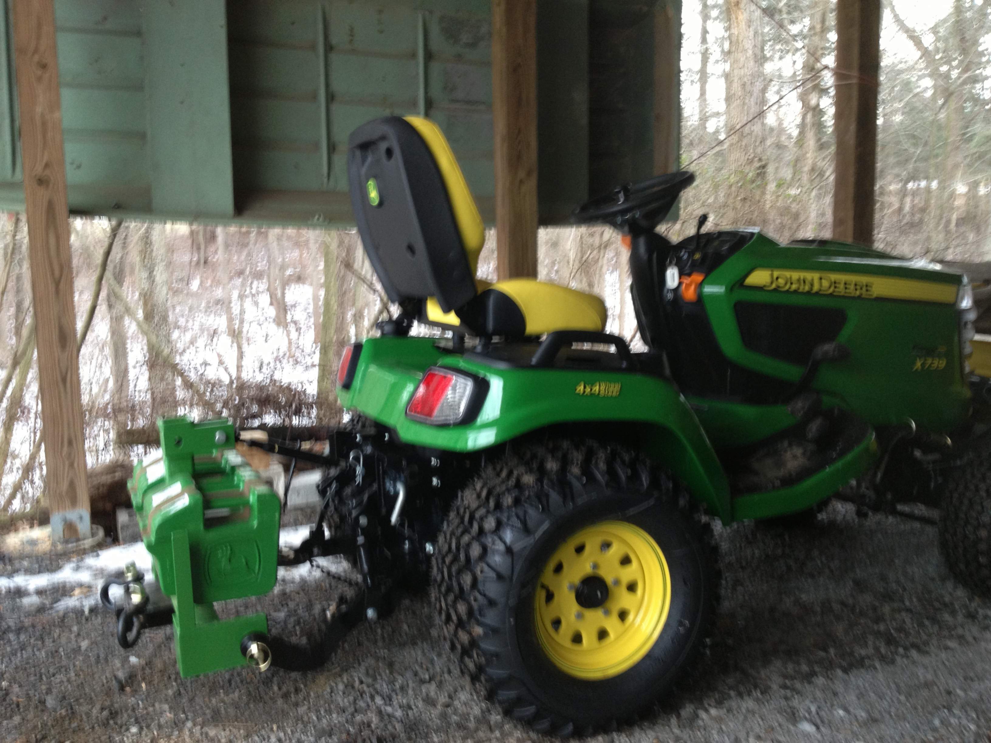

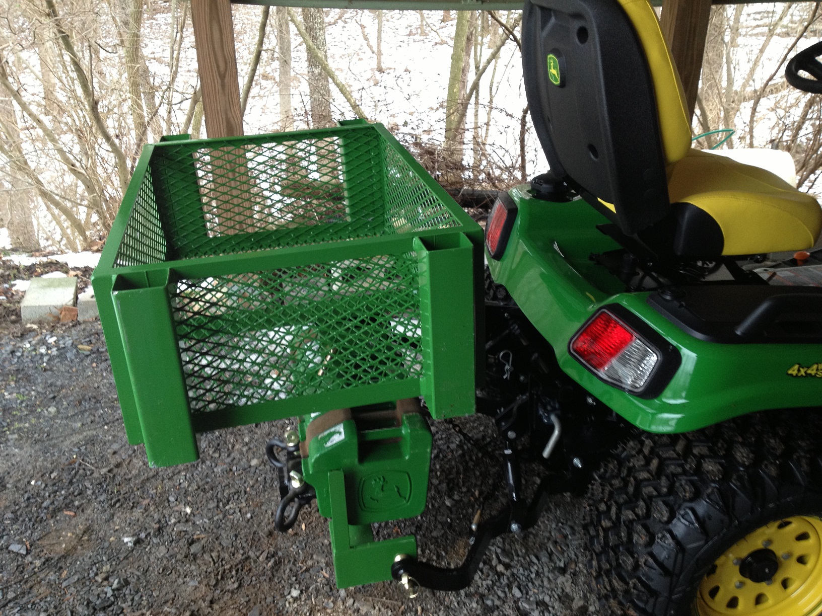

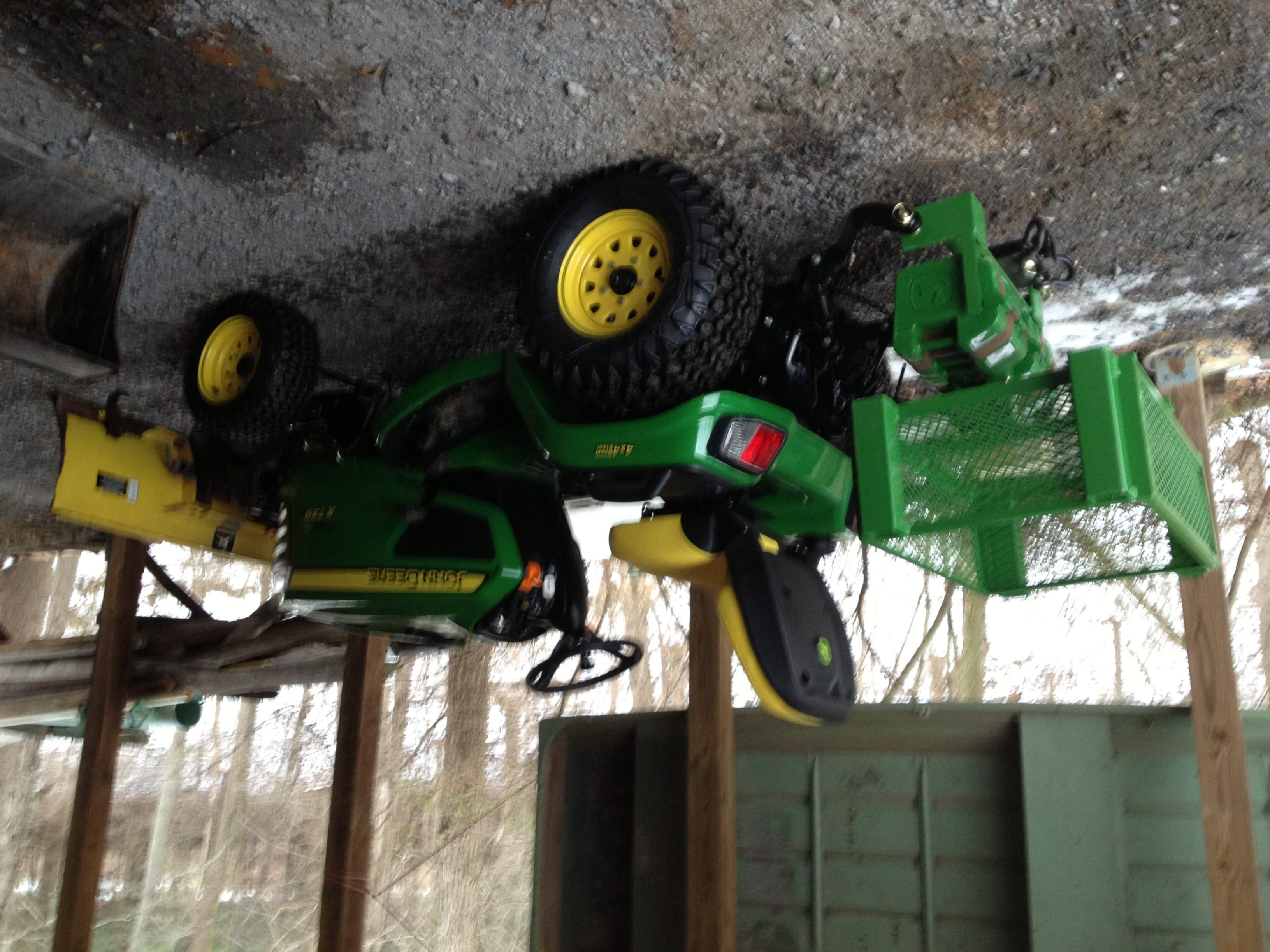

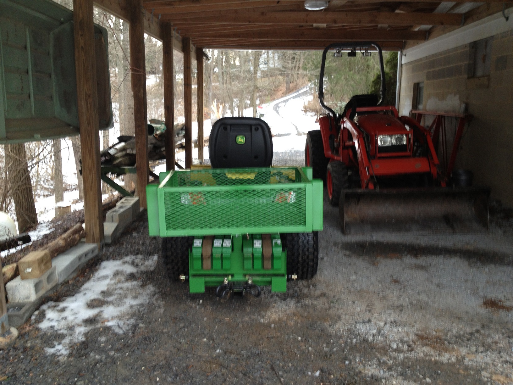

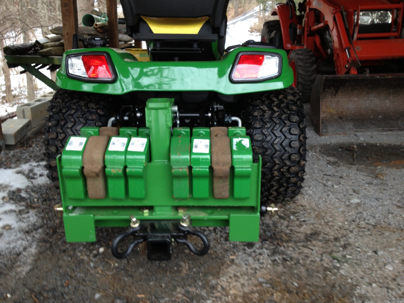

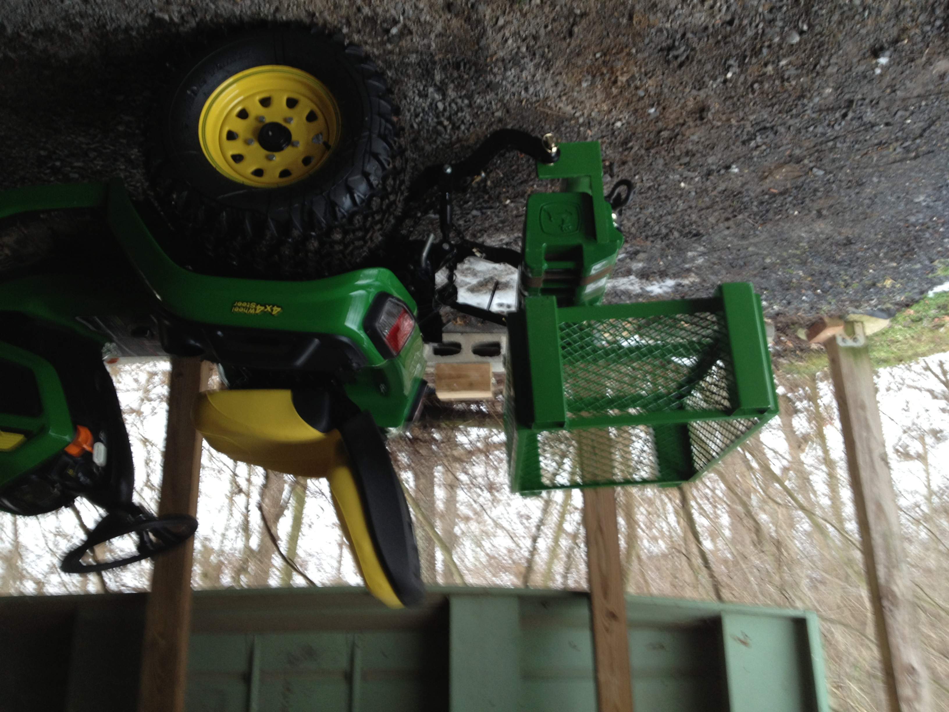

Well it took all day, but I finally got the 3PH hitch installed on my new X739. What a PITA! Then I installed my Omni hitch :)

Don't know why they are upside down. Edited and try again:

I understand that the rubber is to help match up the two surfaces better, but under heavy loading it may lead to loss of preload in the stack. This is not good for a bolted joint and should be avoided. Can you take a grinder to the uneven surface and flatten it out then shoot it with some paint and bolt it back without the rubber? That's a nice looking hitch adapter and I'd hate to see it come loose on you while you're working it hard. ... and do it the very best you can.
