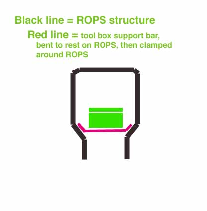

I have an idea, but I need to see the back of a 790, could someone post a picture? I think a cross member could be clamped to the ROPS uprights. A tool box could then be bolted to the cross member, or possibly cantalevered off the cross member? It presumes that the ROPS is behind the seat as opposed to being in line with the seat.

"I have an idea, but I need to see the back of a 790, could someone post a picture? I think a cross member could be clamped to the ROPS uprights. A tool box could then be bolted to the cross member, or possibly cantilevered off the cross member?"
That's what I was discussing in my first response in this thread.
The seat back is a few inches forward of the ROPS (which is slightly canted aft), so there would be room for a smaller toolbox. Of course, smaller is a relative term.
Doing some quick measurements on the fender and behind the seat, a fender mounted box could be 15" long, 8" wide and maybe 8" deep. That would be large enough for a pair of gloves, a couple small tools and odds and ends (which is what the originator of this thread indicate he wanted).
A tool box mounted as Bob describes could be about 20" long, 8 to 10" wide and 12" deep (or a little more). Of course, if it rested on a cantilevered cross member such as Bob described, it could be considerably wider. Being wider might make rigging implements to the 3PH a bit of a hassle though. A tool box this size could be divided off to carry tow chains.
I normally don't have to carry any tools larger then a 12" adjustable wrench, a pair of gloves and a couple lynch and cotter pins (which I'm always losing).
Bob, I will try to get a picture of the rear of my 790. The cross member would have to set just above the sections of ROPS that bend inboard where it mounts to the tractor. Also, we'd have to consider how to attach it (clamps as Bob mentions, I suppose) without drilling the ROPS.
By the way, Bob...what are the dimensions on your tool box? Is it steel or aluminum?

Roy, not waiting for a photo, would something like this work?
