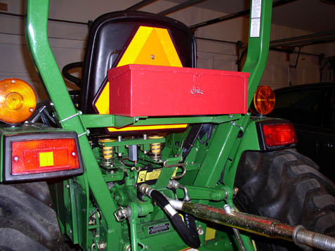

Here is a toolbox mount that I made for my JD 790 tractor. Cross bar is 1.5" square tube and end plates are .25" flat bars. There was some real tricky measuring of the angles between the ROPS.

Hey Beau...now that's a great looking installation!
If you drive your tractor on the road at all, you might want to get an extra SMV sign...maybe using magnets to hold it on.
As far as measuring the angles, I'll use a digital protractor and measure the difference between the slanted and adjacent vertical sections.
It appears you're using squared off U-bolts. Do you notice any noise from vibration on your installation?

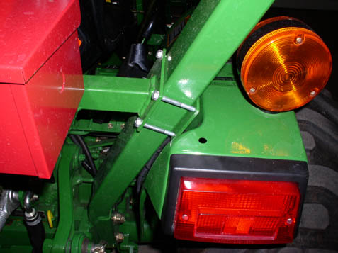

Here is a detail photo of the mounting that I used. The plate welded to the 1.5" square crossmember on the inside of the ROPS is drilled for the bolts to pass thru. The plate on the outside of the ROPS is threaded 1/4-20. Tightening the bolts clamps the tool box mount to the ROPS very solid without any vibration. I put a couple of shop towels inside the tool box to keep the contents from rattling.
Regards
Beau
