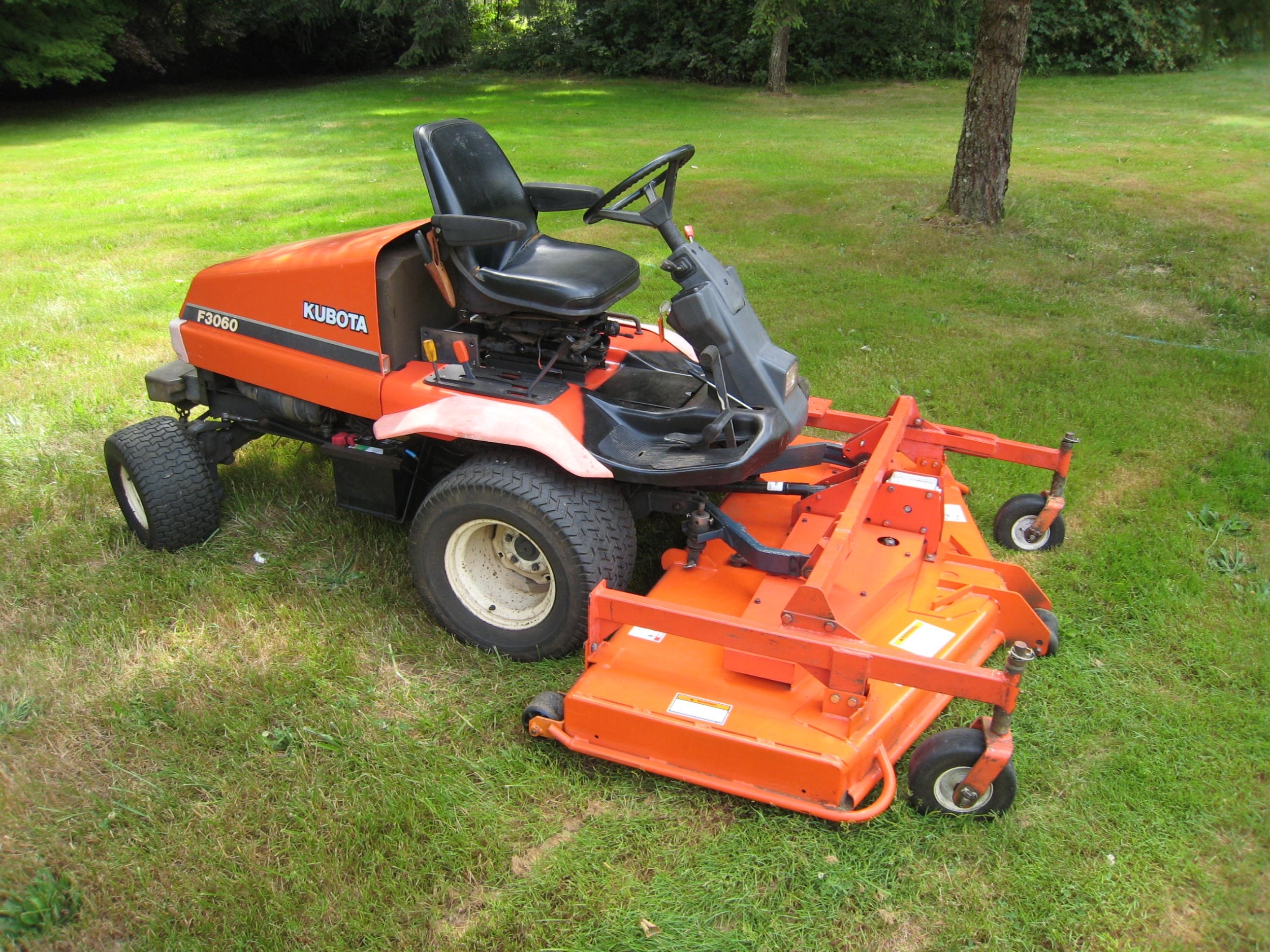

Have you considered this type of front deck mower with 4x4 and turf tires?
Most major manufacturers like New Holland, John Deere, Kubota, Toro etc. offer them.
Excellent for large areas, can access under fruit trees & hedges pretty good, and are built for the long run like commercial use, which is why I would not hesitate to buy used one in good shape but many hours of use.
If I got another front deck 4x4 would be a must have. I have a F2560 and it’s 2wd and it’s traction is terrible.
