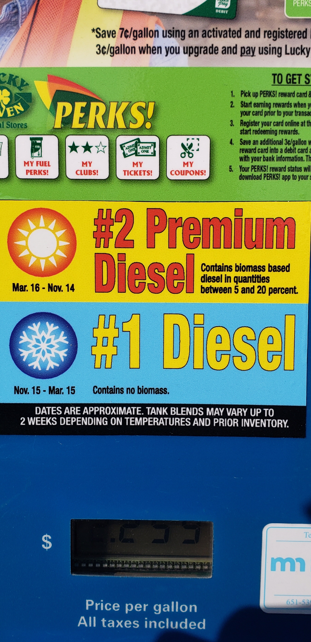

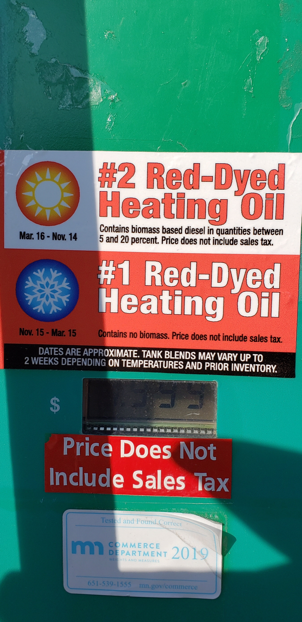

The off-highway pumps at my station are well labeled. #1 from Nov 15 give or take 2 weeks, no bio, reverts to #2 March 15 give or take 2 weeks, with bio. Heating oil different pump because Minnesota is unlike New England states and allows higher sulfur for home heating. But the pumps are clearly labeled. There is one additional station in my small town that sells the same fuel for heating oil and diesel but it is clearly labeled “may contain up to 500 ppm sulfur”. The owner has no clue - he told me that Cenex controls the pumps and the labeling. For him it’s TMI, he only sells what they put in his tanks and doesn’t bother with details. He has too many other things to worry about. So I only buy from the one clearly differentiated if I need fuel and I don’t have my fuel trailer at the main farm when the trucker delivers weekly during the summer.

Well, MHarryE, I stand corrected.
I’ve never seen any labels like that here in the NorthEast.
It “just diesel” here unless the pump is specifically labeled kerosene.
