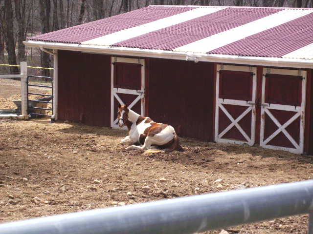

We used the Ondura roofing on our barn going on 5 years ago. So far it has been good for our use. We really like the skylite panels which let lots of natural light into the barn during the day. It was fast and easy to put on. One thing I didn't really like about it was that it uses nails to hold it on. I would have prefered screws with washers. If the nail didn't go straight in it created an elongated hole that needed to be sealed up. One thing that I thought was good about it is that the nails go through the peaks of the corrugations, so water runs down and away from the fasteners. On corrugated systems where the fasteners are in the valleys the water is always running over them making the fastener seals very critical. Like others have said, I wouldn't walk on it. Also, I wouldn't want to have a branch come down on it cause it could poke through. For something like a barn or a shed, I might use it again. I probably wouldn't use it on anything more important.
