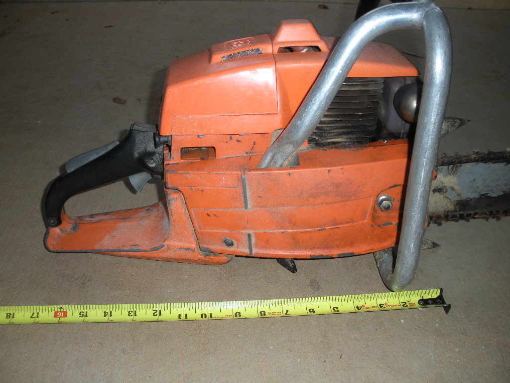

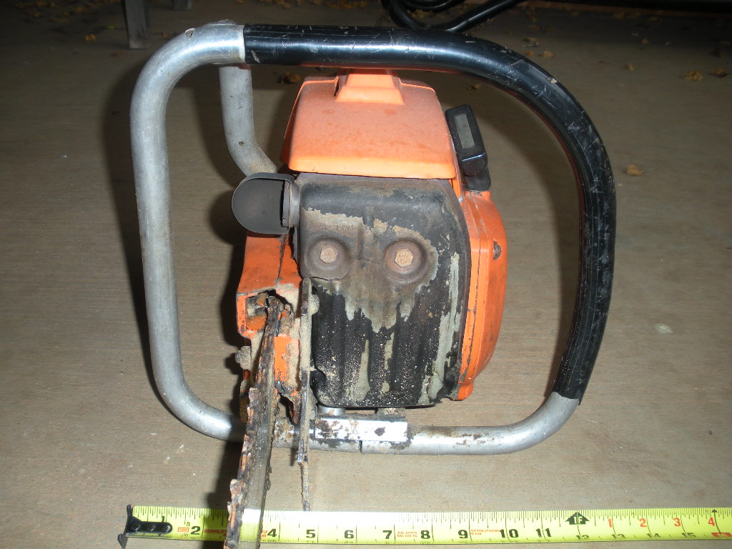

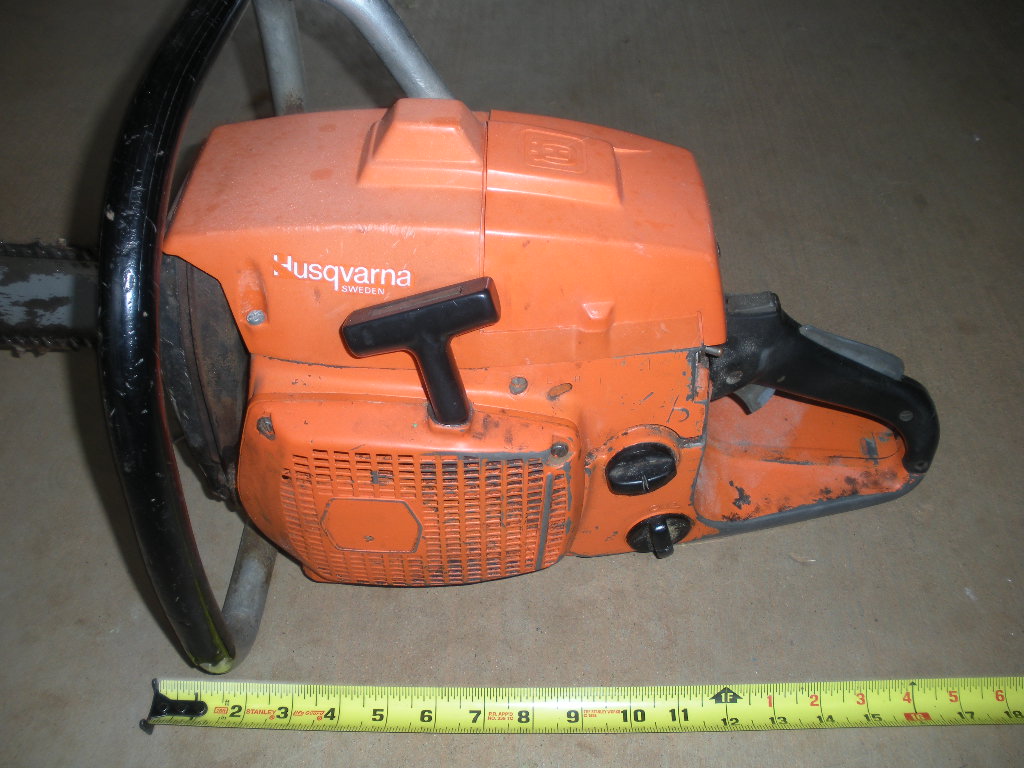

I think... my Husky is a 1100CD or 2100CD from the early 70's. It does not have a chainbrake, so maybe earlier 99cc 1100CD. It runs and cuts great.

RobertN that looks like my 2100 that has had the muffler mods. It is a beast for cutting. I run a 36" or 28" bar with no problems
