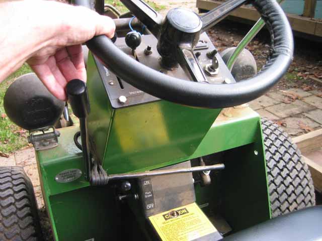

Looking at my BX, It doesn't look to hard to fab up a stick to clamp on the FEL joystick to go over the hood to the other side. Can yiou fab up a left hand side attachment or have a local letal working company fab one for you?

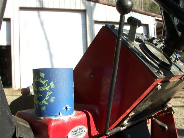

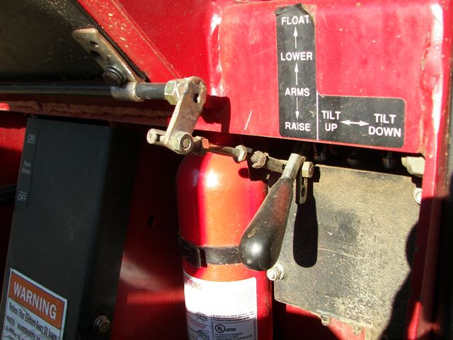

I don't know the exact layout of your machine, but GENERALLY the joystick is just a control lever to a pair of cables that run to the loader's valve block.
It seems to me that an extra long pair of cables and a temporary mount on the left side would do it ?
Your parts counter guy MIGHT be able to find a pair of similar cables from the next size up tractor, but do some measuring first in case you need an extra 3ft and he can only get you an extra 14inches (-:
I am ***_U_Ming clearances and your ability to work whatever other controls are on the left.
If you are clearing snow with a rear blade and your lift control is on the right that would probably be harder to reach and operate than the joystick.
I think I could use my joystick with the left hand right where it is, but the 3pt lift would be an issue if I was bundled up for winter and had to get past a healing right arm.
