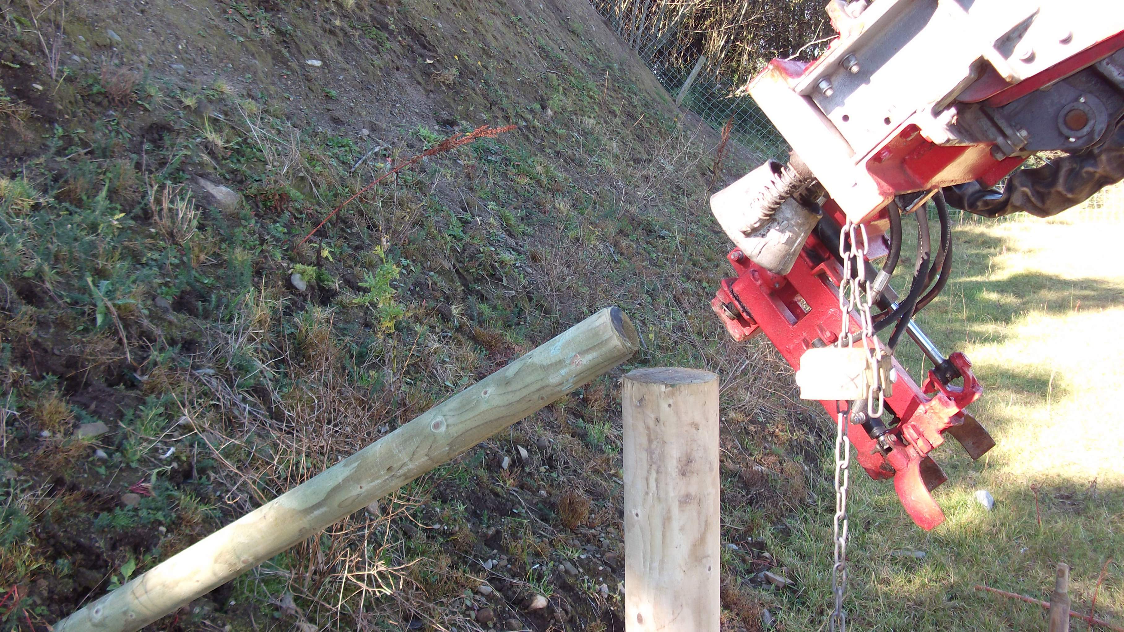

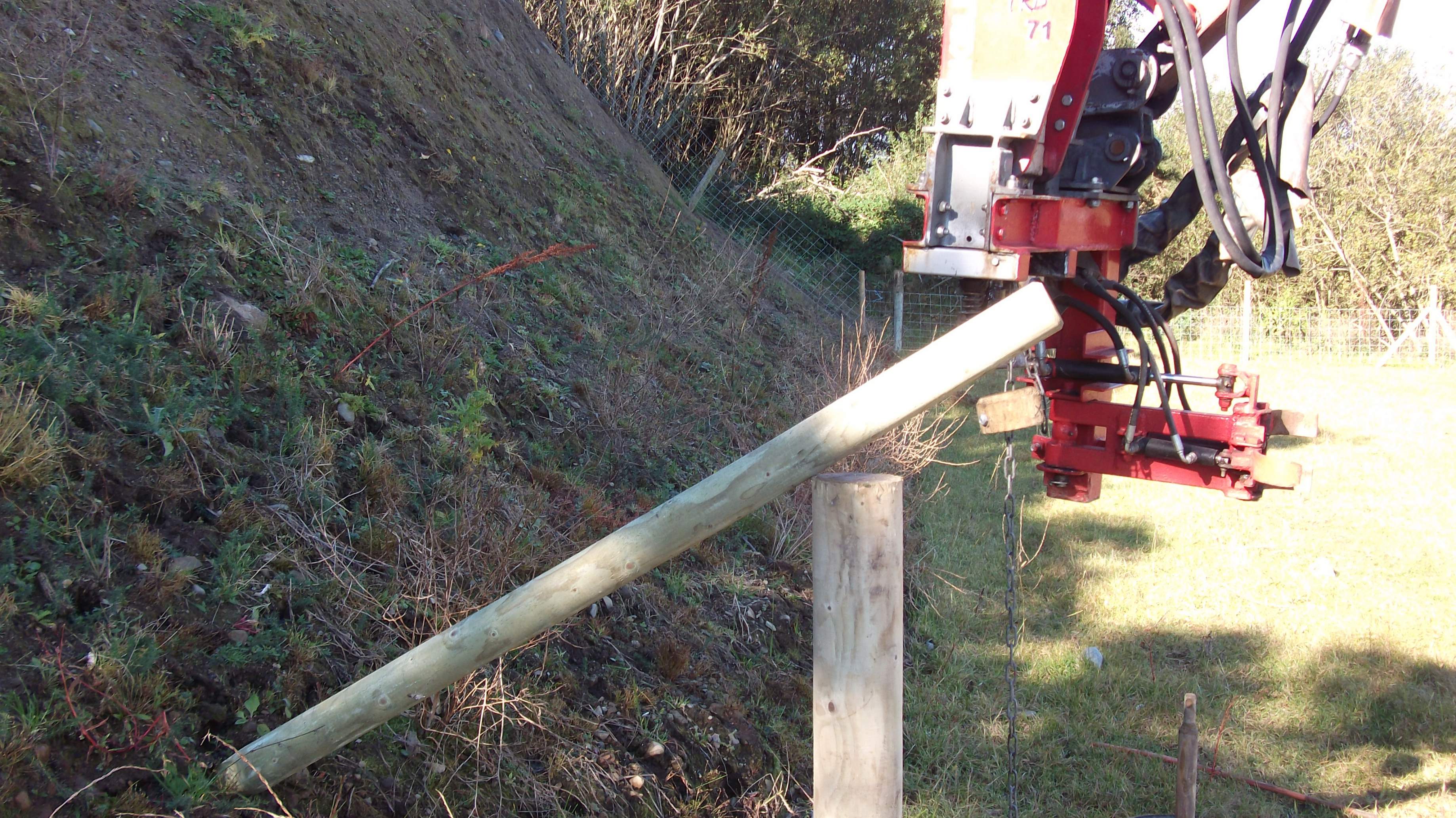

Jan 26, 2014 / one man fencing Thread Starter #11 OP unstable New member Joined Jan 24, 2014 Messages 17 Location kilkeel Tractor caseih 956xl its all home made, keep posts straight using length of chain as plumb line

Jan 26, 2014 / one man fencing Thread Starter #13 OP unstable New member Joined Jan 24, 2014 Messages 17 Location kilkeel Tractor caseih 956xl the posts come pre-pointed Attachments WP_000137.jpg 450.5 KB · Views: 161 WP_000080-1.jpg 448.2 KB · Views: 142 WP_000099.jpg 464.6 KB · Views: 146 DSCF0074.jpg 1 MB · Views: 170 DSCF0075.jpg 1 MB · Views: 141

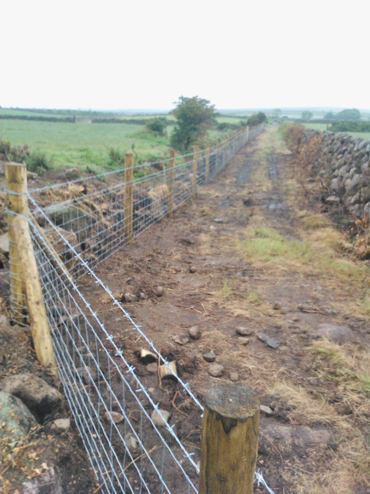

Jan 26, 2014 / one man fencing Thread Starter #14 OP unstable New member Joined Jan 24, 2014 Messages 17 Location kilkeel Tractor caseih 956xl the fencing attachment lets the wire to roll out then strains it without leaving the cab the main part of it is 2 old car rear hubs rolls out and strains both sheep wire and then barbed wire

Jan 27, 2014 / one man fencing #15 K kevin37b Veteran Member Joined Nov 6, 2012 Messages 1,765 Location mansfield,Il Tractor john deere I am impressed .
