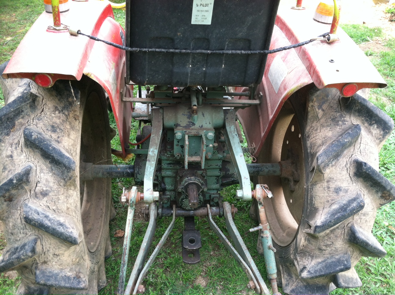

thanks here is a picture he sent of the back end if it will help....

That's a green rear end. Parts are still available looking at the hoye site.

I'll have to defer to the guys with a 1500. It does appear to have some odd ball muffler on it

It definitely looks to be a 1500 (Green) that has been painted to match the 'newer' red color scheme. You can see the Yanmar Green under the red in several places on that tractor, as well as the original black under the spruce green on the transmission case and axles.
As other folks noted, the brake covers are a good way to make a good identification between green and red models. The clutch housing on my YM1500D is made of stamped (smooth) steel whereas the red models have a cast housing (part number '1' on this parts break-down: YM1500GCLUTCH).
