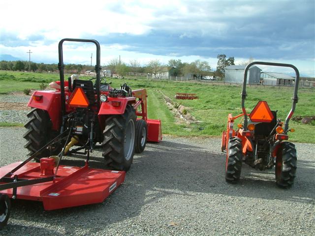

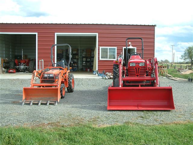

Nope--for example here are two tractors I own or have owned
The little tractor is a 2005 Kubota B7510HST (21 hp engine, 17hp pto, hydrostatic transmission, 4WD, power steering) with the LA302 FEL (4-ft wide bucket, 800 lb lift). I bought it new and used it for landscaping around my new house (10 acres, flat pasture land). Cost: $12600 plus tax.
Three years later I traded it for the big guy --a 2008 Mahindra 5525 (54 hp engine, 45 hp pto, 2WD, gear tranny, power steering with the ML250 FEL (6ft wide bucket, 2950 lb lift) when I decided to plant hay on 6 acres. Cost: $18K. It's shown with a 6-ft wide Hawkline brush hog mower- cost $1100.
You wouldn't want to use the 5525 for landscaping and the B7510 is useless for handling large haying equipment (large disc, baler). Something like the B7510HST would be a good choice for landscaping, garden and orchard use.
The 5525 is on the small side for haying large acreage (say more than 50 acres).
I'd say go with a new or late model used 30-40 hp CUT with hydrostatic tranny and FEL. There are many choices. Most TBNers go with a local deal who can provide service at a reasonable price.
