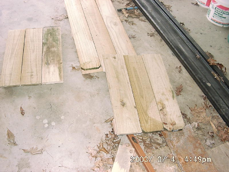

But, fortunately I did have a couple of good stout trees uphill from my muck hole and 35' of logging chain. I used the method of wrapping the chain over the bucket and hooking it to the bottom lip in a dumped position. I also dug out some of the muck in front of the rear tires and built some "pallets" from some 6' PT fence pickets from HD for $.99/ea. I cut them in half and nailed 3 of them together with three 2x4's width wise to give me a 3'x18" solid pallet to put under the rear wheals.
My first pull I got almost all the way out of the holes when I had to take up the slack in the chain and on the second pull I moved another few feet into some muck that my front tires buried in. I just kept moving some 2x6 planks from behind to in front of the tires and taking the slack out of the chain. I really think the pulling with the bucket did 90% of the work. I was a little afraid that the stress might bend the top of the bucket, but it didn't /forums/images/graemlins/smile.gif

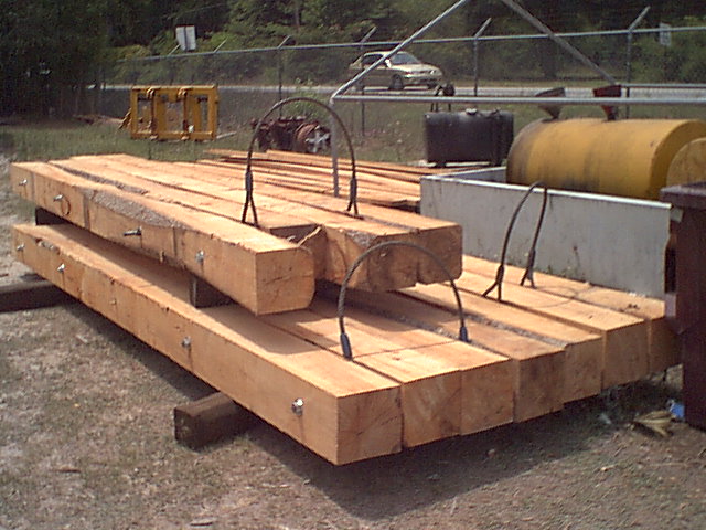

When we dig muck out of old lakes, etc.. we make large mats for our excavator out of 8x8 or 10 x 10 and steel cable.. you made a smaller version of them .. sounds like they helped. I'll post a pic of our large dragline matts if I have one.

Yea, I've seen these in use around the logging trails. Mine wasn't quite as rugged, I think one of them bit the dust, or should I say muck. /forums/images/graemlins/smile.gif

here's a picture of my plats
