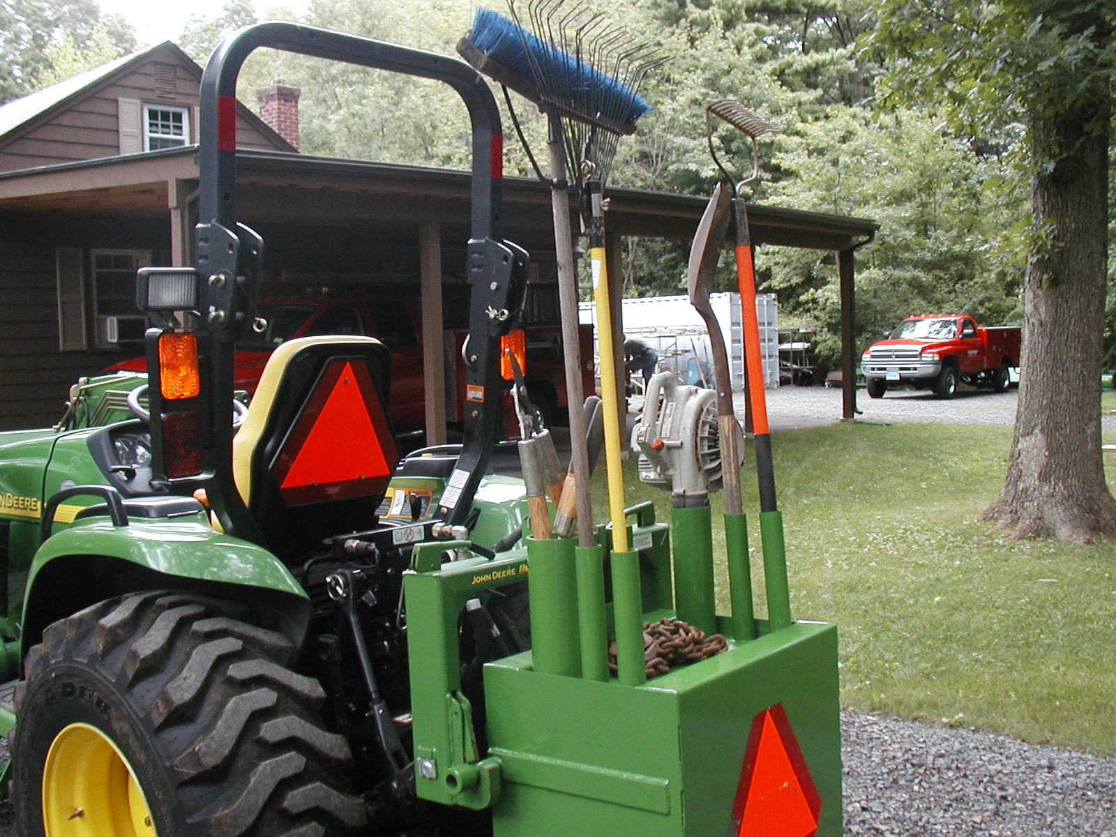

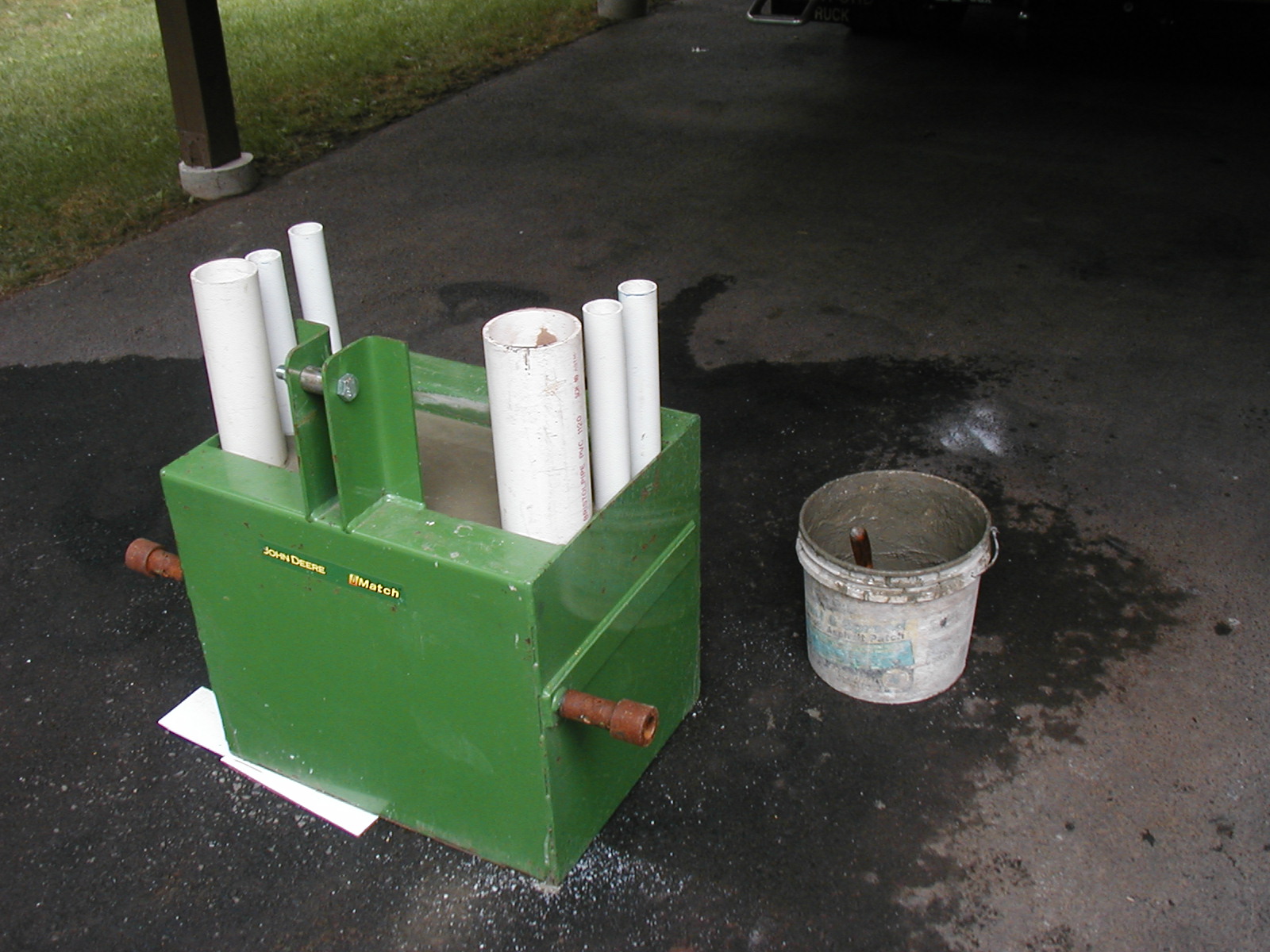

My box is a standard JD, you might need a heavier one or the side extenders, but alot of guys cast their own in a barrel or a box etc etc.
Think it weighs ~ 500 lbs? it's enough now for the loaders capacity.
It's not hard to do, just enter a pile on an angle.
JB.

Hey JB,
I appreciate the picture. Had me wondering about the pipes for a second there. Now, that is what I would call, practical!
Mike
