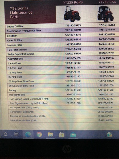

michman2117, thought you might be able to use this
