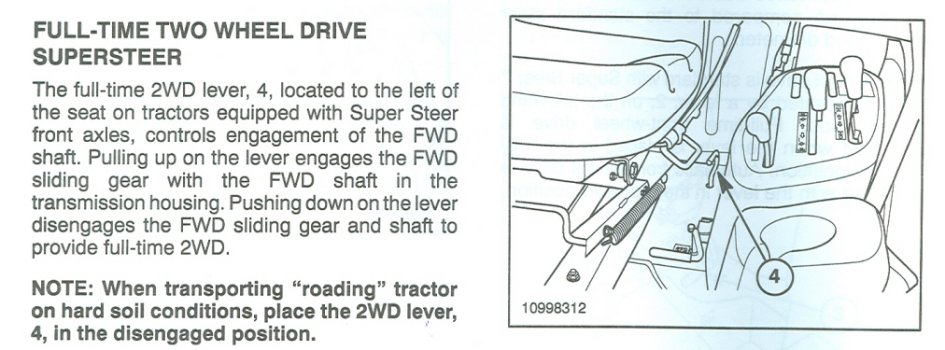

Murph maybe I wasn't clear, even though you have Sensitrak, when you "road" the tractor, there is a lever low and to the left rear of the platform to positively lock out the 4WD. It should still be used in cases such as that, check your operators manual.

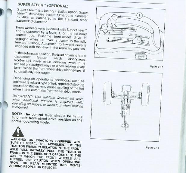

Pine, I did look the owners manual. I can not totally lock it out. I only have a lock in and an automatic. I am sure as I go down the road it would not go it but according to my manual I don't see where I can lock it out so it won't ever go in.
murph
   / OOPS 4WD Down Road #14
Murph it would appear that all things are not equal on the Sensitrak/SuperSteer from rig to rig. See what my OP says for "road" use.

   / OOPS 4WD Down Road #15
Yep it looks like there is a difference. Here is my manual.
murph

I'll bet that PineRidge's tractor is quite a little newer than yours, Murf. The 4WD disconnect was added somewhat after class III production started.
