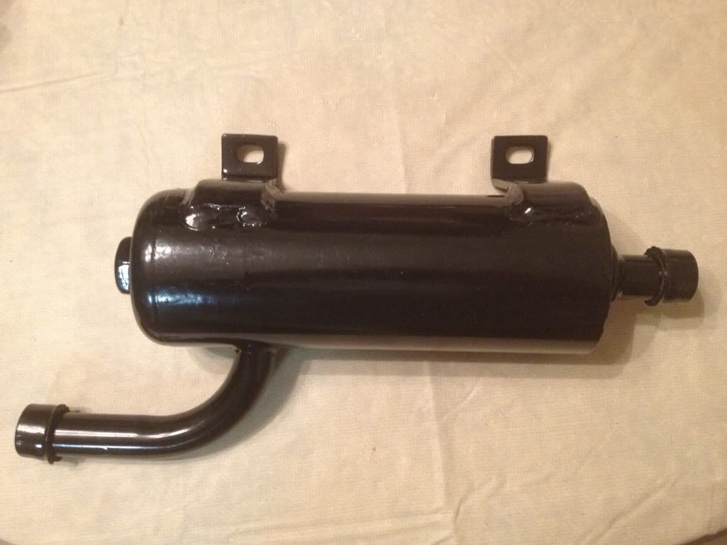

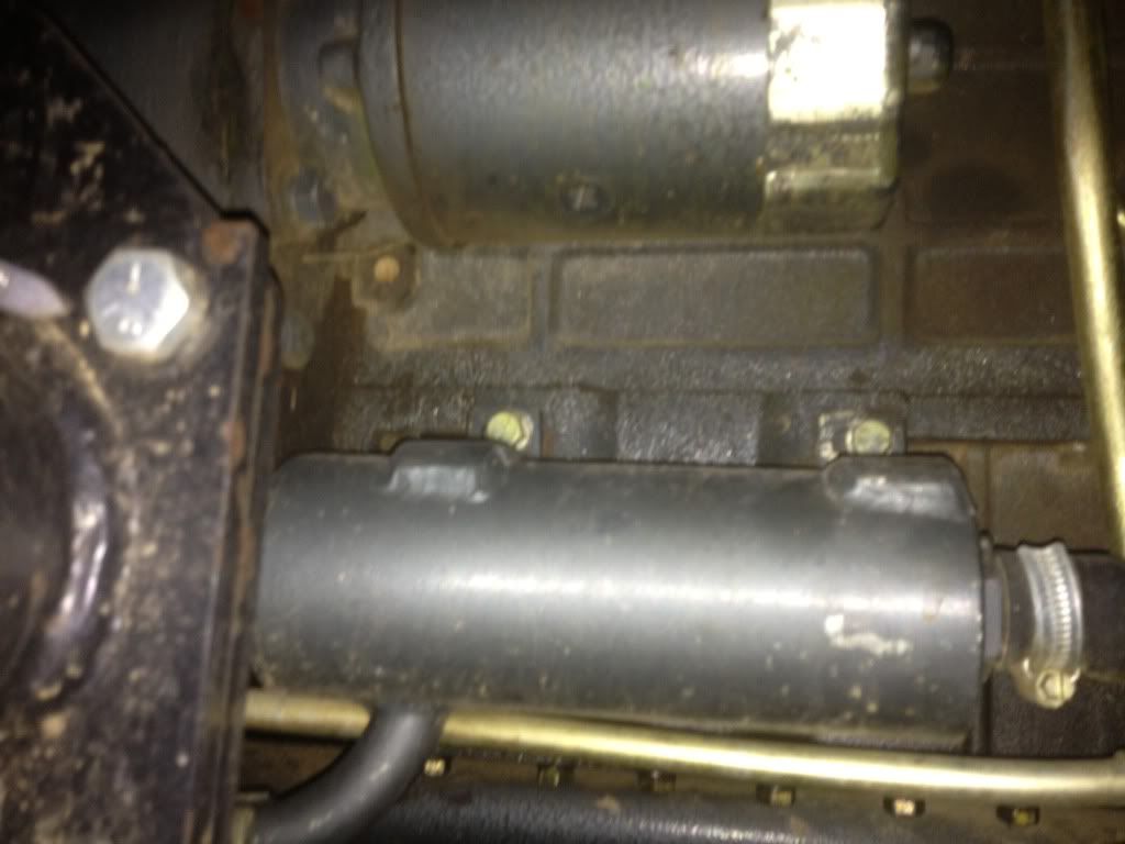

Mine has a hydraulic filter on the lower right frame rail basically under the step.. The housing is a fairly heavy duty metal tube roughly the size of a rattle paint can it has a tube coming out the side of it on one end and one going in the top of it on the other.. I happened to have bought a whole new assembly mistakenly just a couple of weeks ago. Mistakenly, because they come apart and you can replace just the filter inside which is all I wanted to do in the first place but I didnt know they come apart. I will take a pic this evening of the location and the spare so you have a good idea of what I tried to describe.
   / Opening hood on Foton 404 #15
Ok so figured out how to attach pics finally. I was a little off on location, it is on the right hand side but just under my starter, not under the step. First pic is of it's location on the tractor. Second is of the new assembly not mounted.

Next time I'm at my daughter's place, I'll check out her machine and see if there's a filter in the same place as yours. Any idea of the part #?

The whole assembly is slightly overkill unless you have damaged it it is part number FT400.58X.040 and I found it at affordable for $89
The cartridge inside is only $29 and is part number FT400.58.040c
The thing opens like a thermos to replace the cartridge and can be done while its installed on the tractor. Make sure to have your drain bucket handy.

Sounds like your tractor is about the same age as mine. The hydraulic filter is located as shown Wa11bangers photo the is a slight difference on my model. Located behind the filter and mounted on the same bolts is a plate that carries the power steering lines. If you completely remove both mounting bolts can be a bit of a struggle (to say the least) to get everything lined up to put the bolts back in.
