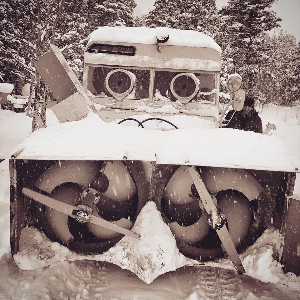

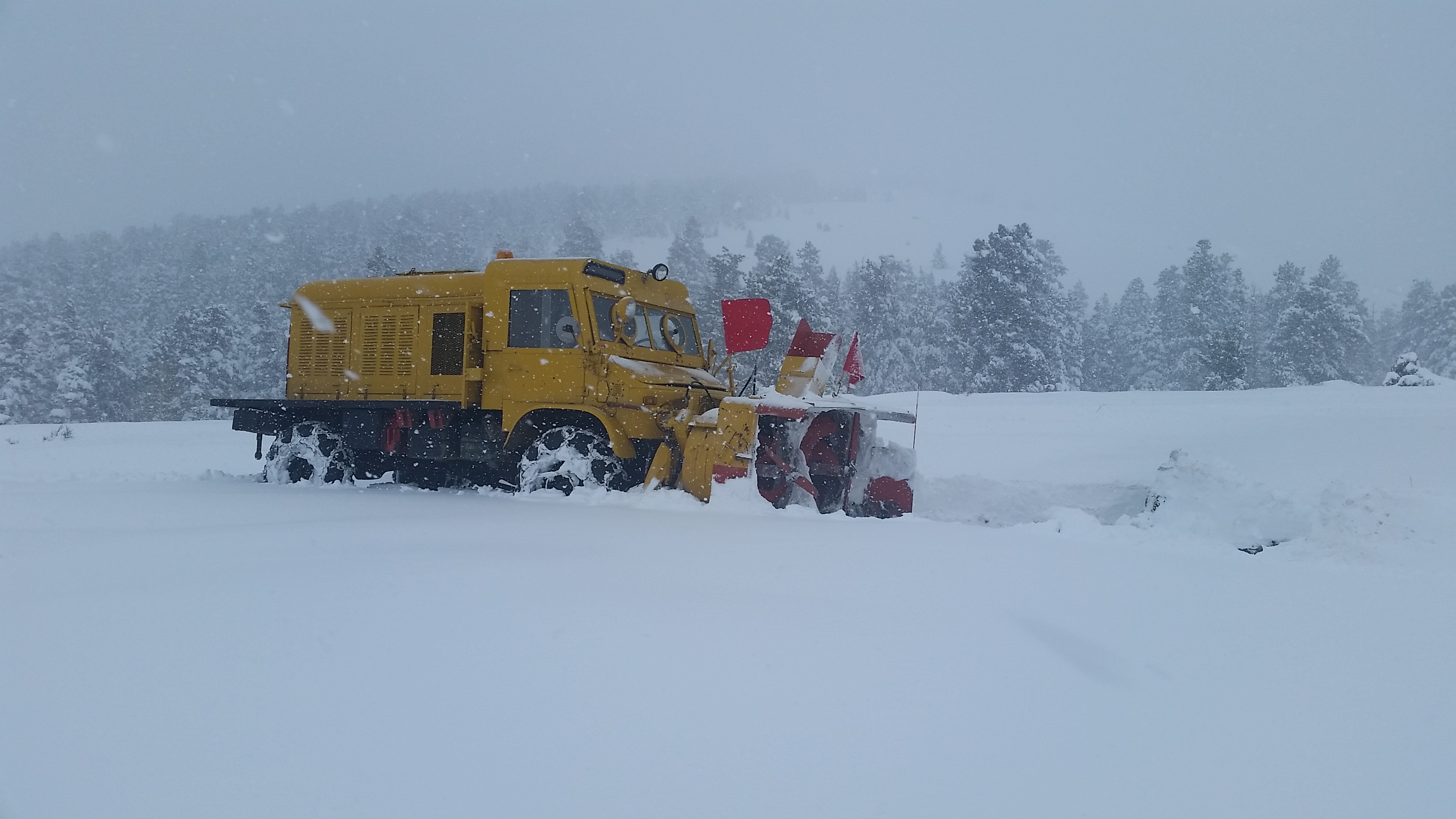

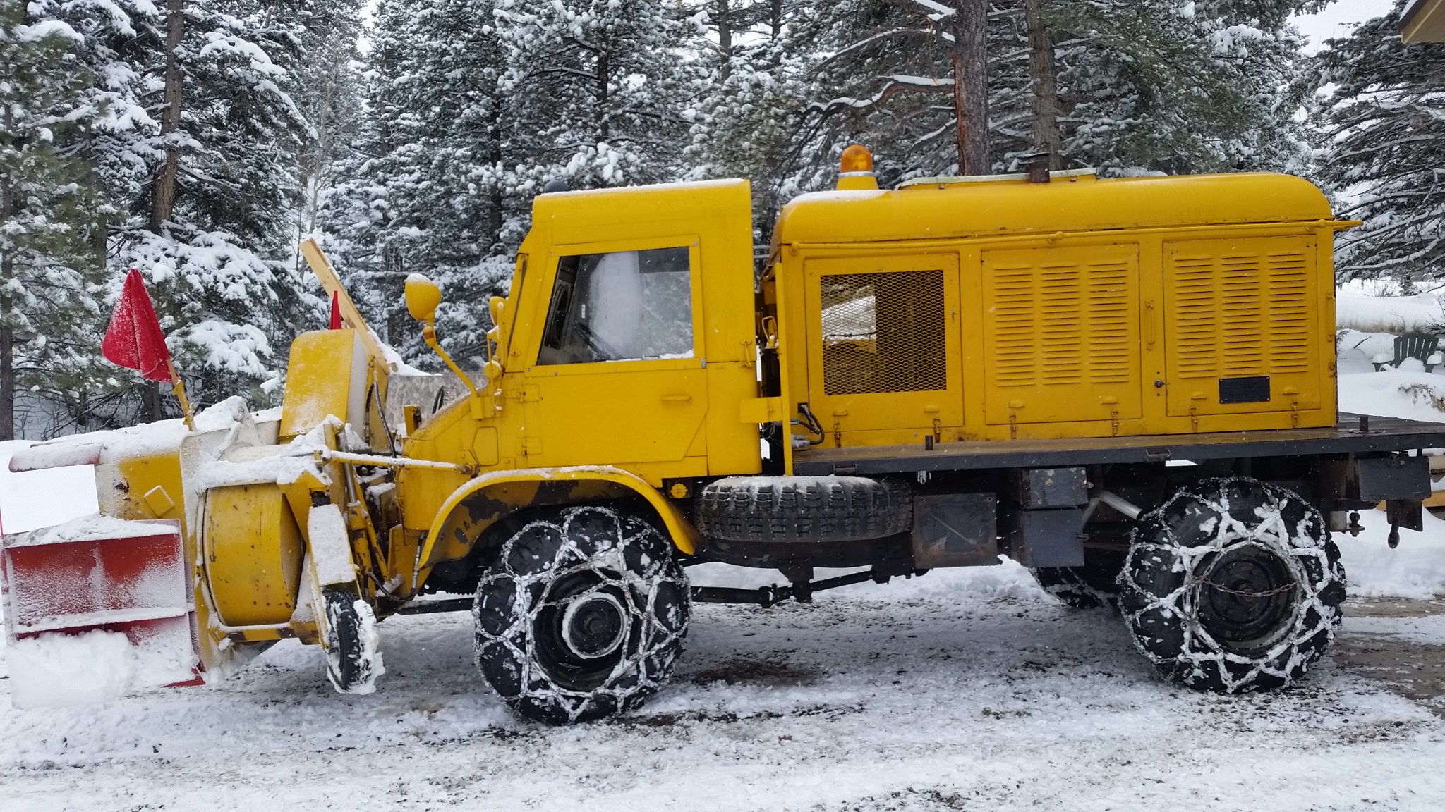

+1 on the unimog pics
These might already be posted in the Snow Weapons photo thread, but it would be 400+ pages back. :)
   / Operating 3 point blower in raised position- why not? #26
Thanks. So there are two Engines in that thing? What are they? Both Liquid cooled? How much snow will that thing drive through (generally speaking)?
   / Operating 3 point blower in raised position- why not? #27
Correct, the truck has a small gas engine, the blower is powered by a 110hp turbo diesel, both liquid cooled. They both have a port in the cooling system where you can insert a gasoline fired heater called a "swingfire". The idea is that you can warm the engines without access to AC power for a block heater. Similar to a modern Espar heater but crude by comparison. With "normal" snow (i.e. soft enough that you sink in to your knees when you walk on it) it will clear a path through 40 inches of snow. For wind-drifted snow that is stiff enough to drive on top of with a tractor (until you break through) it will break through about 30 inches, slowly. Here is a video of crawling through very hard snow about 2 feet deep-- notice my friends walking around on top of it.
And sorry for the thread drift -- the Unimog blower cannot be operated more than about 3 or 4 inches off the packed surface due to drive-line vibration. Maybe when it was new that wasn't so much of a problem. The PTO looks ok but it is almost 60 years old.
