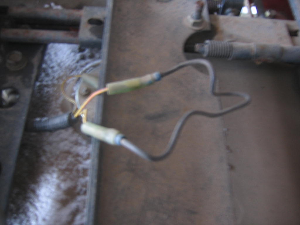

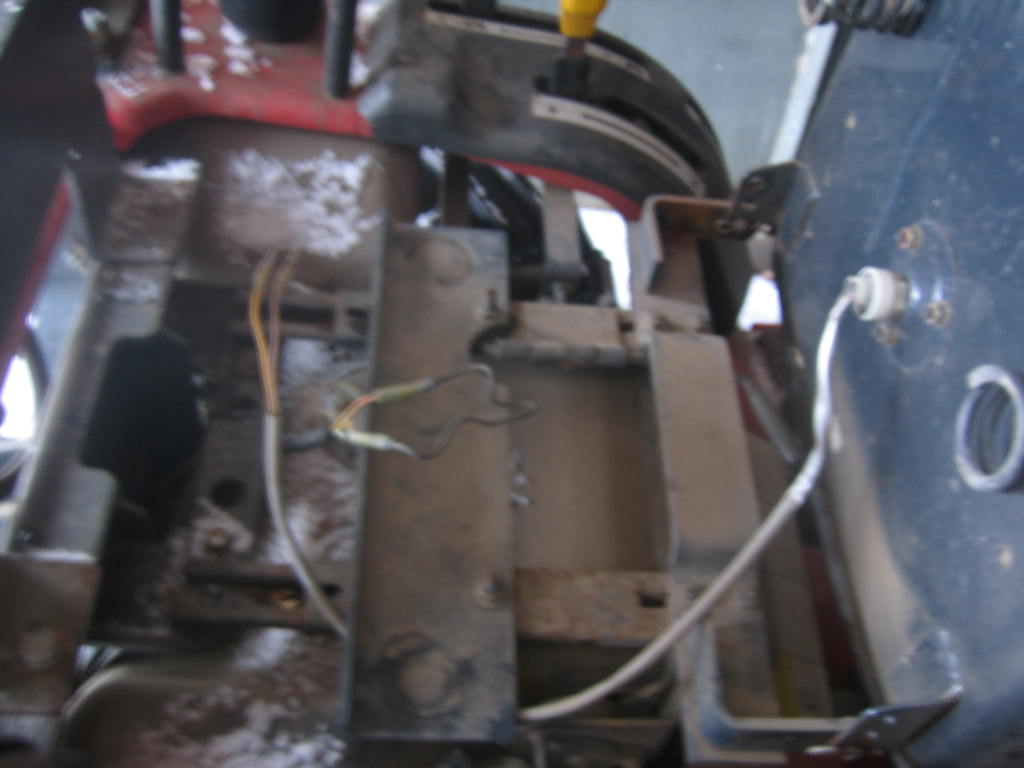

   / Operating a PTO Driven Chipper on a MF Solo #7
A big complaint on the early GC2300 was the seat foam would freeze, not allowing the seat switch to work. Really hard to use a snowblower. Had to jumper it to clear snow, also worked well for the chipper. IMG_8220.JPGIMG_8222.JPG
