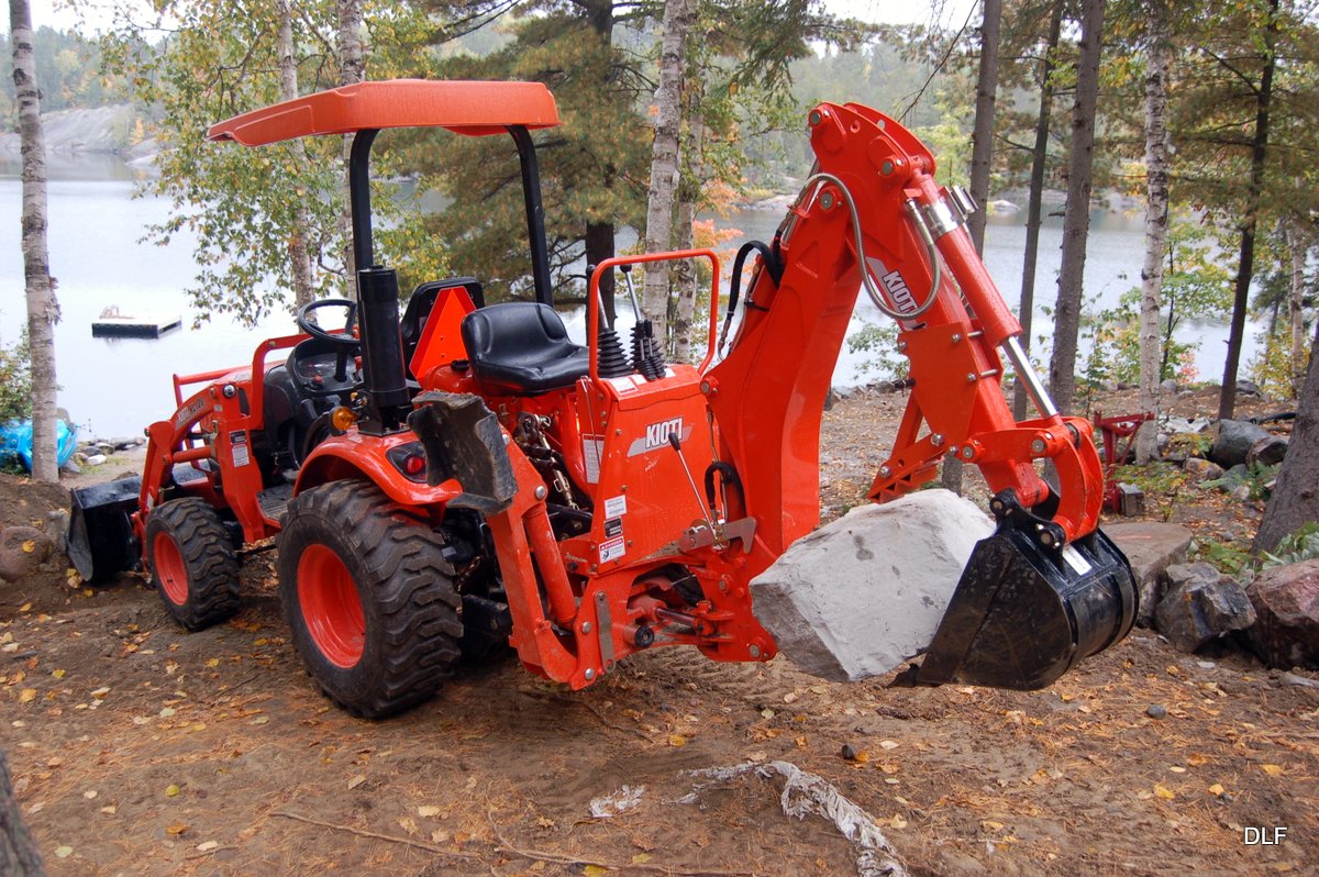

I operate mine at 2500 rpm. Hydraulics on the CK20 are very smooth and you can control speed of the backhoe easily by feathering the controls. I feel that operating at lower RPM causes the Hydraulic pump to work too hard. Not sure if this is so but based on what I have been told this is how I do things. Experience and experimentation will tell you what is best for your situation. View attachment 364420View attachment 364421View attachment 364422
Note the boom latch in the photo holding the Rock. Don't know what I would do without the backhoe.

DF, I see you put larger stabilizer padds on yours - I think I need this too. Too much moving around. Also I like your thumb. I was thinking of making my own - not sure it's worth it. Where did you get that?
   / operating KB2365 vs KB2465 backhoes #12
Hi, I have been running mine a bit lower lately and seems to work fine. Keeping the RPMs around 2100. The pads came with the backhoe.
My thumb was made for me by a neighbor who has a metal fabrication shop. Our local dealer has some of them fabricated for different booms, not sure how much they are selling for or what shipping cost would be. Their email address is noelvillerenta@hotmail.com
