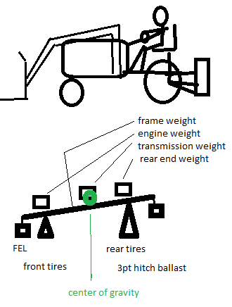

Hey there,
I'm a relatively new owner of a Branson 2910i with 4wd and a BL-20 loader I just had installed. I was recently talking with my brother, who has a John Deere of similar size. A dealer told him he shouldn't operate his loader without some sort of ballast on the rear, as it will ruin the front end (bearings?). I understand the need for rear weight for trying to life anything heavy, but never thought about the other issue. Can anybody fill me in on this?

Without enough weight on the rear of the tractor, every time you pick something up with the FEL you are in effect trying to tip the tractor forward and stand it up on the front axle -- meaning the front axle is carrying the entire weight of the tractor AND the load in the FEL. Whether this causes damage in the near- or long-term is dependent on about 87 different factors.
For this reason, suitable ballast at or behind the rear axle is needed. Filled tires and/or a heavy implement (such as a ballast box) are the solution(s).

tetter totter effect.
no ballast on rear = front tires. will end up seeing more weight being placed on them.
when there is more weight on rear. the "fulcrum point" changes. below the tetter totter errr on the tractor. further back towards rear wheels. other words. if you added a huge amount of weight on rear end of tractor. the tractor would end up doing a "wheelie" were front tires come off the ground. *been there done that* disc, and bush hog i have for the old allis chalmers tractor will get front end to want to easily come off the ground.
your "MANUAL" for tractor / FEL should state approx how much weight to add to rear of tractor. when doing FEL work. so the correct ratio of weight on front tires and rear tires is placed. and help prevent flipping tractor backwards doing a wheelie. or prevent doing a front wheelie.
a heavy 3pt hitch implement, such as a box blade, rear blade, bush hog. etc... many folks have used as rear ballast weight. if tractor is more dedicated and/or you will be maneuvering in ugly sharp small areas. a rear 3pt hitch ballast box can help reduce how much sticks out behind the tractor.
many folks fill rear tires with a fluid. rear tires with fluid adds weight, and the added weight is not placed on the axle. the added weight is also lower on tractor, and helps lower "COG" (center of gravity). and can help deal with tilting (working tractor on hills). be careful some fluids can be toxic, if they leak, some fluids can rust the rim out. it is normally not that expensive, to get a "tube" installed. tube might help prevent a leak from a thorn or nail as well. due to some extra thickness of rubber thorn or nail has to stick through.

It should be said that loading the rear tires, while improving some things, does not reduce the load put on the front axles. For ballast to achieve that goal, it must be behind the rear axle. It must, in effect, attempt to wheelie the tractor. Only that effect is reducing load on the front axles.
