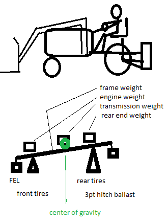

adding fluid to rear tires, or adding rear wheel weights. i do not see how could add more weight to front tires.
if anything front tires, would see total tractor weight (minus) not counting fluid in rear tires and/or rear wheel weights.
other words, tractor would still trying to do a front wheelie. but rear tires being held down, by fluid in rear tires and/or rear wheel weights. ok bad statement, fluid in rear tires, and/or rear wheel weight. is adding weight to the "rear fulcrum" and in that not adding any weight that is trying to be balanced out. errr that is completely not correct either. yikes it has been way to long since being in school. i done forgot the "depends" or the "except" words being repeatedly being said...
If you fill the tires, but it isn't enough to hold the rear end down yet, then when you lift with the loader and the rears take off, you have put the entire weight on the front axle, just as mentioned before, but now it is even heavier than it was when not filled. If they lift, it's all on the front. The only way is to counter it behind the rear axle. Even then, if it lifts, it's just that much heavier. You have to have enough back there (or far enough back) that it can't lift off the ground. Once you achieve that, you add even more and it starts to transfer weight back to the rear axle.
Precisely what I was trying to convey, just in different words:thumbsup:

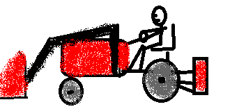

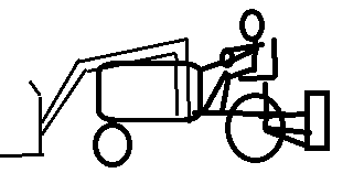

And special thanks to the artistry of Boggen for this jem that helped us understand what a tractor looks like - lol. Can I have this for my avatar?
Seriously, Boggen I want it!

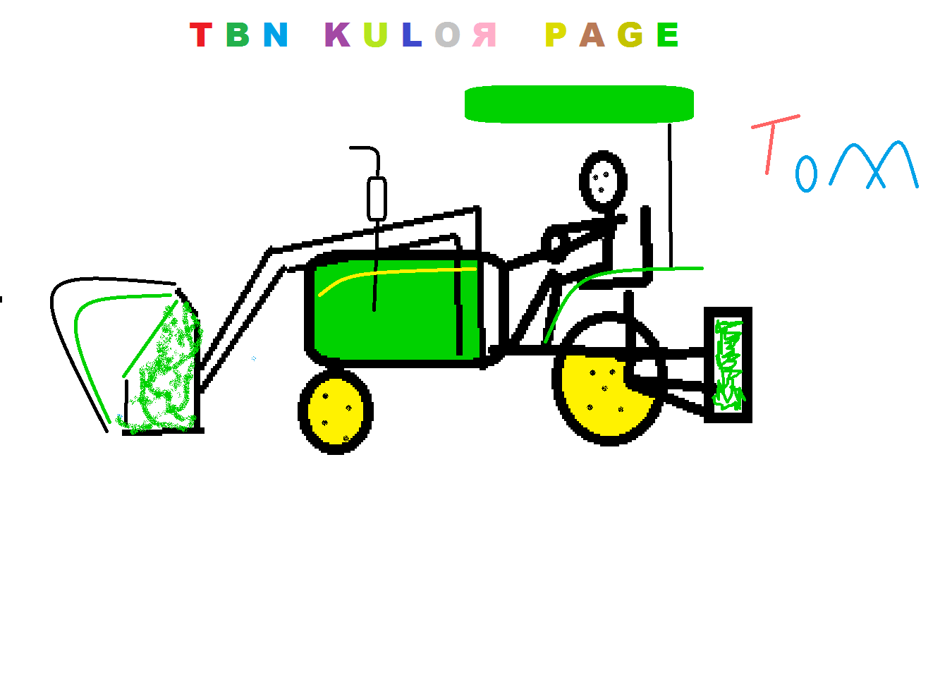

Thanks BOGGEN

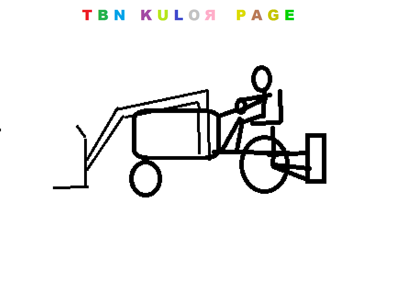

"boggen" tractor coloring fun on T B N
save the image and paste in paint
here is mine:)

use the noted picture to your hearts content, you asked, good enuf for me, to return the respect.
Thanks BOGGEN
here is mine:)
View attachment 292927View attachment 292929
wow! little bit of color. really made that pic! nice job!
