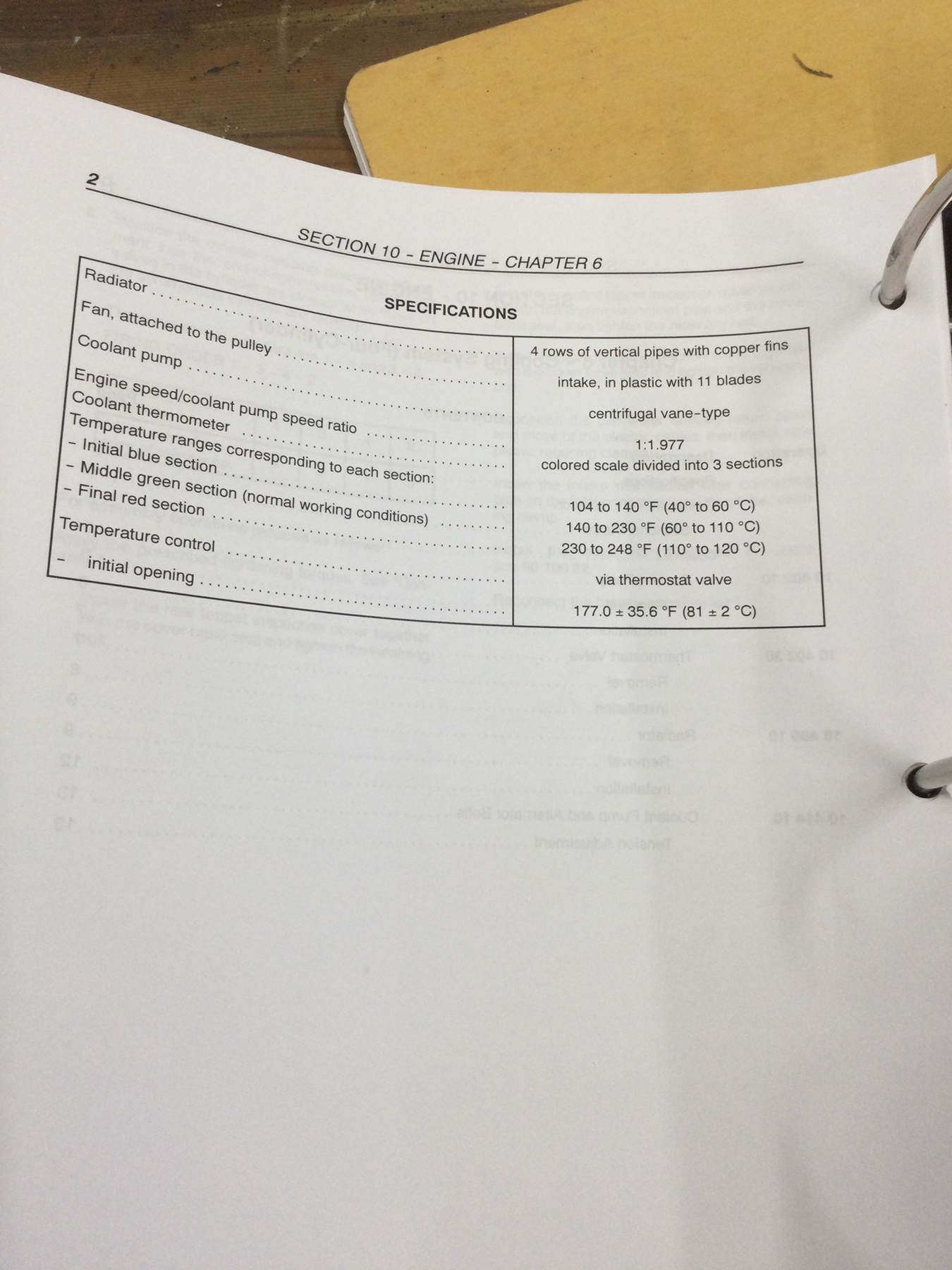

Replacing temperature sensor for the fourth time. This time going with mechanical gauge.
Anyone know what normal operating temp. is for this tractor?
Thanks
I have the manual for cab version of that tractor(TN70da). It’s the same engine. The green range on the factory gage relates to
140 -230 F. See the pics
