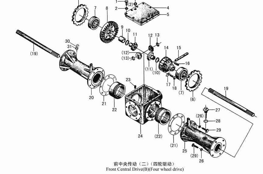

I'm completely on board with the "open" concept for the rear end, I've got no problem with care and feeding of the diff rear diff lock. And I acknowldege the transfer case gear assembly as the weak link, when front wheel drive is engaged.
The question that remains unaddressed, is why my front wheels rotate with seemingly equal traction - or lack of. Neither of the Jinmas nor this KAMA front drive exhibit behaviour identical to the rear drive. I can make them lose traction, but not individually. When I get into a low traction situation up front - they BOTH spin. And there is no front diff lock control. This is far more apparent on the KAMA than was on either Jinma, but then again the KM454 is almost double the horsepower.
I was boxblading snow with the KAMA this morning, on several occasions both fronts and one rear started spinning. Grabbed the diff lock lever, and had all FOUR spinning. I used snow as an example this time, as it was the most readily available "source" of low traction. But I've also observed this behaviour in gravel/dirt/mud on other occasions, hence my earlier questions.
It's clear how the rear diff lock essentially shifted the rear (open type) differential from 1 wheel drive to 2. But how is my front wheel drive performance (or lack of) consistent with the "open" differential concept, when compared to that exhibited by the rears?
//greg//

   / Operation in 4 Wheel Drive? #47
</font><font color="blue" class="small">( HARF? Maybe I know it by a different name. What's HARF stand for? )</font>
I wish I could provide more info Rick, Google is stumped too. There's always a chance it could be a glitch in the Chinese>English translation, but I'm at a loss to figure out any alternative interpretations.
Look at the front diff diagram (attachment), upper left corner. #34, #36,#37 comprises the planetary gear set. Standard stuff. But then look closer to the center; #25, #27, #28 are identified as components of a "harf" gearset.
If you want, I can upload a diagram of the rear diff as well. But if you take my word for it, there's no mention of "harf" - or anything even resembling "harf" - in the REAR diff parts diagram or parts list. Just the standard planetary gearset, and that's it.
In my KAMA at least, I'm wondering if this additional gearset has something to do with my front end not working like what others are calling an "open" differential.
..greg..

   / Operation in 4 Wheel Drive? #48
Greg, they call that a "Half Gear" in the TS book. So I think HARF is a typo. These are the gears driven by the planetary gears, which are driven by the differntial housing driven by the knee bone connected to the shin bone...
I thin you will find that if you raise one rear wheel and one front wheel your KAMA will not move in 4wd.
I think the reason you see both fronts pulling is because the back is pushing and so the traction of the fronts stays pretty equal. If you jack up one rear wheel and chain the tractor to a big tree with the front wheel in soft dirt, I think one wheel will end up turning more than the other. Not sure this is a good idea to actually try this, might pull the tree down!
If you want to check the differential you should raise both wheels of the ground and with 4wd engaged, turn one wheel and the other will turn in the opposite direction. If you do not engage 4wd you might end up turning the driveshaft instead of the opposite wheel.

Both 28s are just the gears that spline onto the axle shafts.

</font><font color="blue" class="small">( Greg, they call that a "Half Gear" in the TS book. So I think HARF is a typo. These are the gears driven by the planetary gears... )</font>
I thought of that Chip, but the fact remains that there are no harf OR half gears listed as components of the KM454 rear differential. Did you look at both KAMA exploded diagrams to which I referred? I also examined diagrams of the transmission assembly, the Shaft 1 (driveshaft) assembly, the Shaft 2 (brake) assembly, and the PTO shaft assembly, and the final drive assembly - looking for a rear equivalent. No mention anywhere - of harf/half gears - except in the front diff.
Attached by the way, is the front diff exploded diagram for Mike1's JM304. Interestingly enough, that particular Jinma model doesn't seem to have that extra gearset (by any name).
The "boxblade in snow" example I described earlier is little different than your tree experiment. The tractor was completely motionless, held back by the grounded boxblade. All four wheels were spinning simultaneously. I throttled down, lifted the hydraulics to clear the boxblade, let the clutch back out, and the tractor drove right out of an otherwise immobile full traction situation.
//greg//
