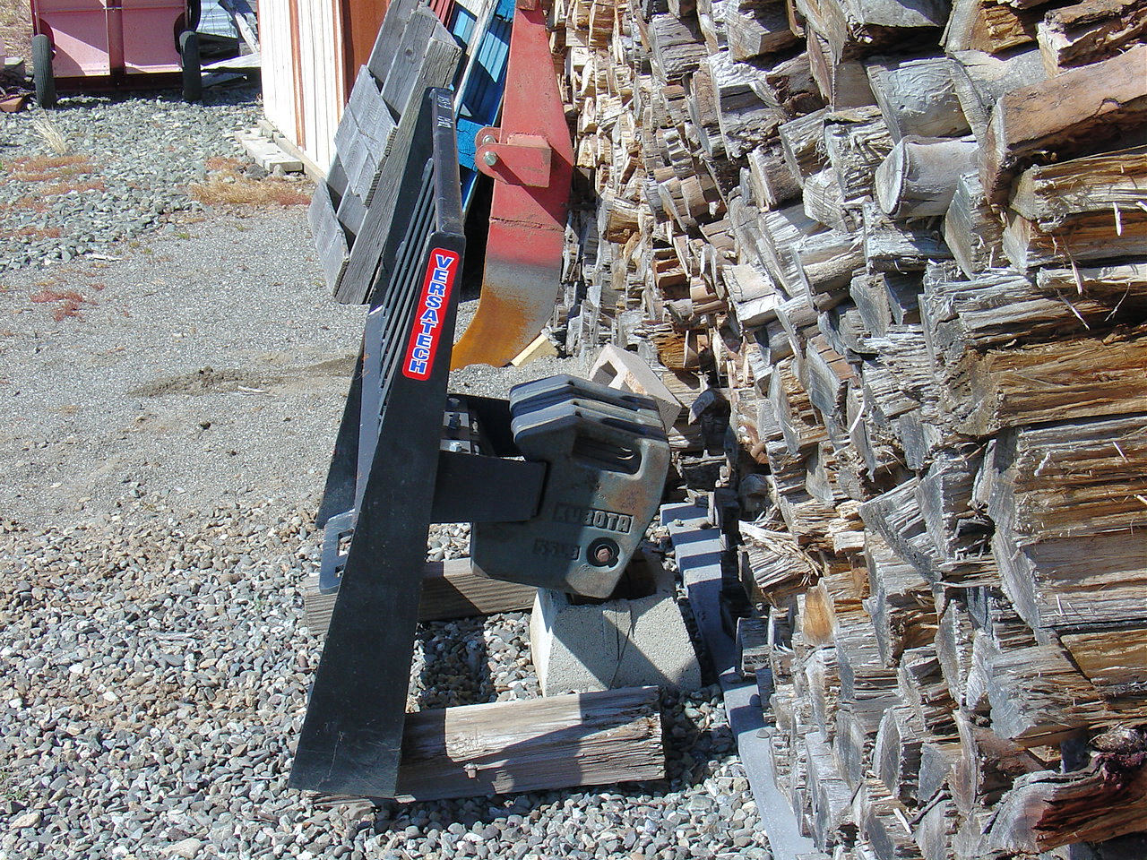

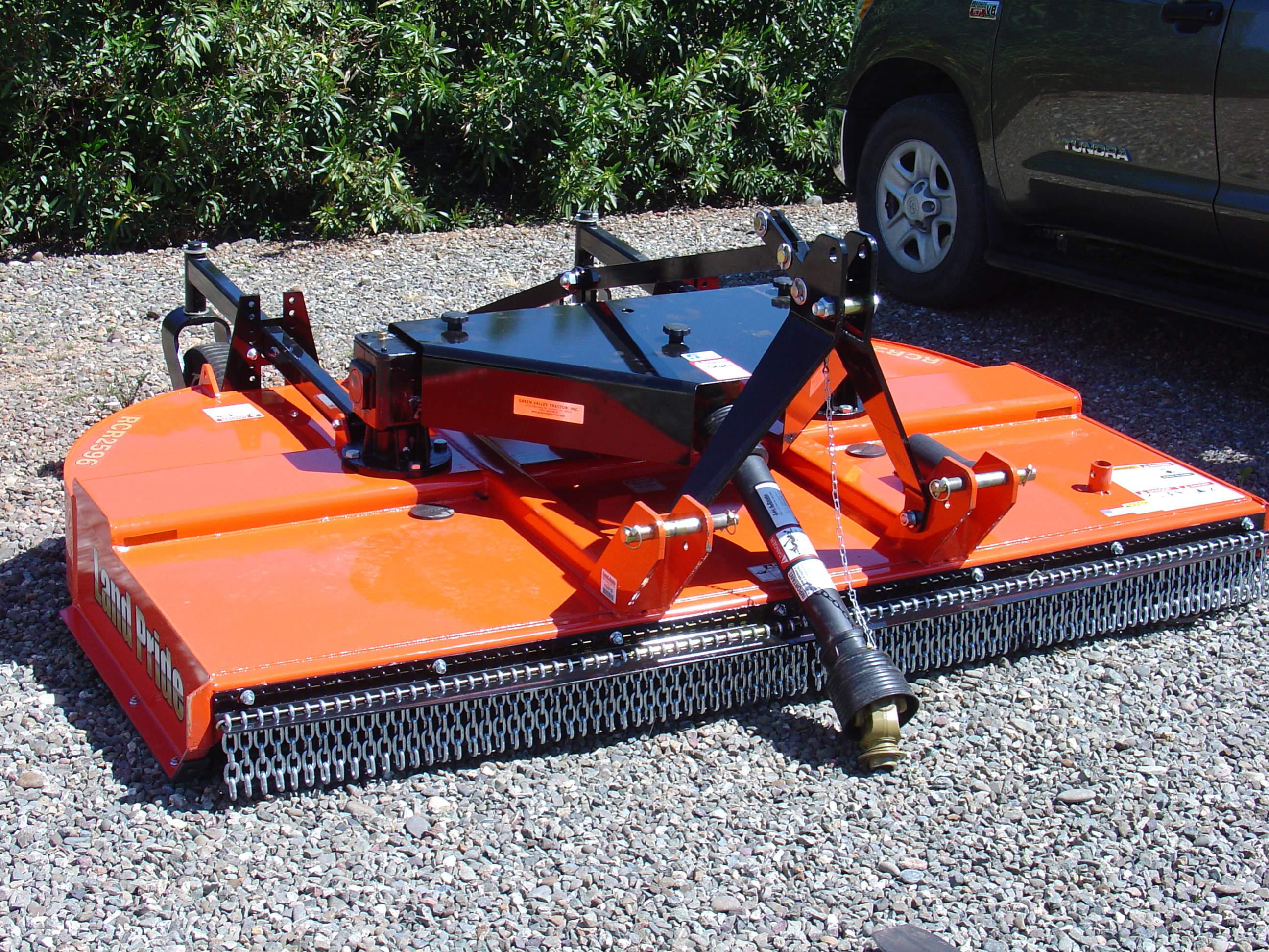

My rotary mower is an 8' Land Pride that weights 1380 pounds. No problems, but I do leave on the front bucket or use a QA front weight mount.
As far as filling front tires, it is resoundingly NOT recommended. There are a variety of reasons that you can search for here on TBN. For one, it is he|| on the front suspension.

You need to USE that Landpride.....wayyyyy to clean.
   / Opinion From Kubota M7040 owner about rotary cutter. #15
I'm hoping that was his "Look at my new toy" picture. :)

Yes, that photo was from a couple of years ago on the day it arrived. It looks "somewhat" differently now. :thumbsup:

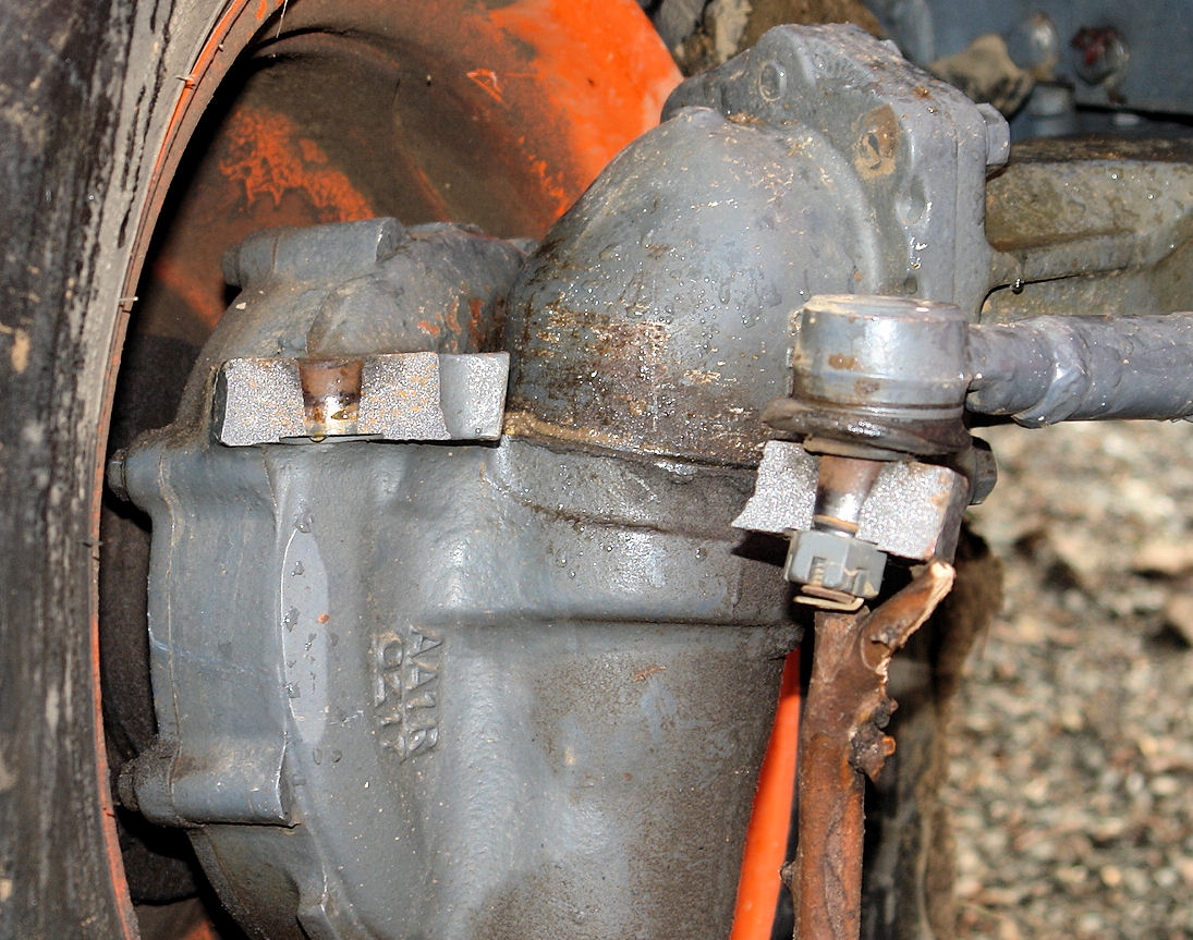

Concerning loaded front tires, I should not have used the word "suspension". A much better word would have been "components". Loading front tires can lead to failures like this. (L3650) The tires were not loaded, but the owner tried turning the tire that was stuck in a ditch so there was resistance to rotation.
