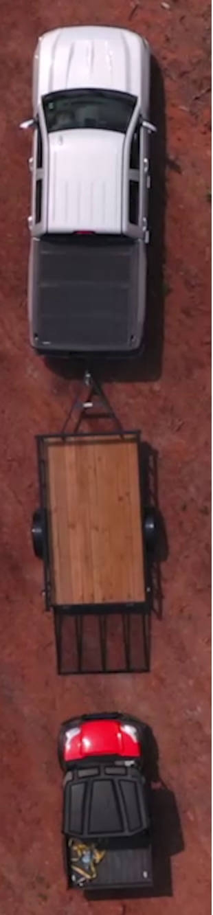

I see that they're selling the trailers by the GVWR, with the actual Payload being around 500 pounds less than the GVWR depending on the trailer model. So, your mule is rated at about 1,600 lbs. That could well be over capacity for a 2,000 lb GVWR trailer, especially after you add a driver.
Nonetheless, in the video on their home page, they show what appears to be a mule, or similar ATV being carried on a single axle wood deck trailer, and it fills the trailer end to end. That would be an argument in favor that at least one of their single axle trailers can carry the mule.
I can't tell the exact model being used for the Mule. It may be one of their heavier duty single axle trailers with ratings from 2,000 lbs GVWR up to 2990 GVWR.
