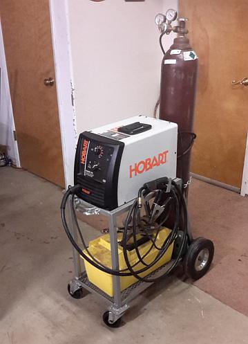

As a 70 year old diabetic with 5 bypasses and arthritis, I don't think I'll live long enough to get my moneys worth out of a 220V welder. So yesterday I went back to Rural King to get the item number to order a new one. Then I noticed they had gotten a new Hobart 140 in. So I brought that home with a new helmet, and leather apron. I already have welding gloves that I've been using to tend our fireplace with. Now it's time to unbox it and start learning.
Thanks, everyone,
Joe

I have run a Hobart Handler 140 for several years, and may not be perfect in some cases, but will run some good welds both with gas or as a flux core.

I say it again... Love my HH140...
Dale

Now You're cookin !! Anyone with any interest in Welding will be hooked once they get their 1st welder. You're 70 now so you can run the 140 for 10 years and see what you think. Good Luck !!
