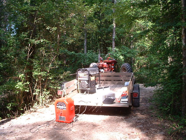

I bought a Lincoln 225 AC at Lowes for about $230, I think, a year or two ago. It was the brand (and same unit, I think) I was used to from a job I had years ago. I run it with a 12k generator amd have been entirely pleased with both how well it works and how quickly I've re-learned to strike an arc. The one most enormous improvement in welding is the auto darkening helmet. How'd I ever without?
Wm
Here's a shot of my welding shop-
   / opinion on AC arc welder #18
Nice shop willflick,
All you need is a benchgrinder, saw, angle grinder and air compressor and you can rent yourself out as Mr. Weldit. I bet you'd be busy all the time.

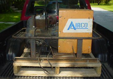

Will,
Your shop looks just like mine, except I pull mine with an Allis 410S.
I found an Airco Wasp ll-E, it's an engine driven AC machine that should do me just fine.
