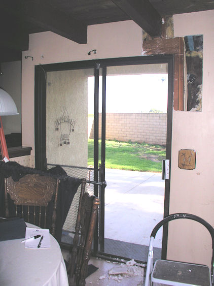

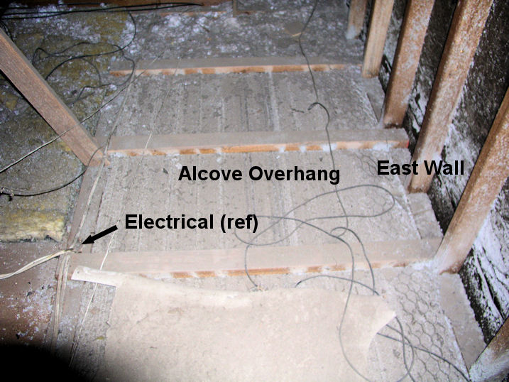

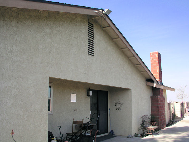

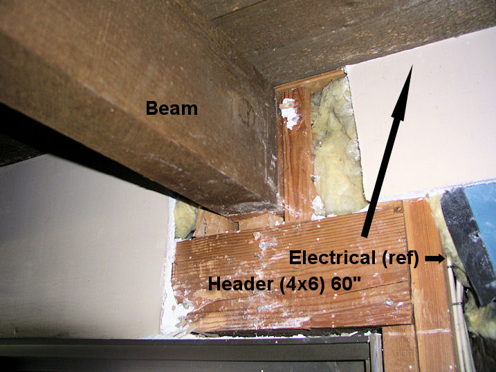

Thx again to all for your help. I've added some pix to (hopefully) better describe the structure. The ceiling beams do not extend beyond the sliding door alcove wall and, I believe, are mostly decorative, supporting the wood ceiling panels. I've identified a common reference point (electrical ref) in the closeup and attic shots. From the attic shot, the 2x4 through which the electrical goes appears to rest on the end of the ceiling beams & cripples, but does not appear (to me) to be a significant load bearing structure. The beams appear to be nailed to the header cripples and rest on the header via wood "inserts" as seen in the expanded closeup.
I believe most of the load bearing is accomplished by a 2x12 which forms the "hangover" of the alcove area. Hope this makes sense.
There is precisely 6.5" between the existing door and ceiling beams, so to SuperD, I would likely have to rip the LVL pieces you describe.

Much better pictures this time, RichT. From what I can see, and please correct me if I'm wrong:
In attic pictures, the alcove gable wall rests on top of a 4x12 beam. There are 2x4's spanning the inside wall and alcove ceiling support beam. The mesh between the 2x4's is probably the backing for the alcove ceiling stucco, right? There appears to be a brace sitting on top of the inside wall top-plate that probably provides additional support for the roof, right?
I cannot see which way the ceiling joists run but if my eyes can be trusted, then the insulation seems to be running parallel with the interior wall where slider is going to be installed, right?
On the inside, the decorative wood beams are quite substantial, if they are solid lumber. Clearly, the fact that they don't protrude past the exterior wall and supported from outside members means that they are being supported by the inside wall where your slider is. Without looking under the insulation in the attic, I cannot tell if the ceiling joists are being supported by those "decorative" beams or if they are supported at the ends. I can see in the interior pictures that those dark colored beams are resting on a shim above the header and are nailed through the cripple studs. Clearly, the weight of those beams are resting on the header.
Ok, presuming that all that is correct. We know that this wall is supporting at least 1/2 the weight of the stucco ceiling in the alcove. We know that the wall supports at least the free weight of the dark colored ceiling beams. We do not know if it supports any of the weight of the ceiling members. We do know that there is some transfer of weight from roof to that wall by means of a 2x brace. While it is not supporting all of the roofs weight, it is probably keeping the roof from sagging by means of shortening the span.
From the pictures, my opinion is: I think that there is no way that you "extend" the header, it will need to be replaced. The wall is clearly supporting some weight but the good news is that it's not as much as there could be. Temporary supports: The two dark colored interior beams are clearly resting on the header and the cripple studs. The alcove ceiling is probably going to be OK without but I'd rather err on the side of caution and toss up a 2x6 supported at the ends and shimmed up tight. Before removing the header, I personally would want to spread the weight of the roof brace across the top plate. The top plate is probably just a couple of 2x4's stacked flat wise. If you've ever walked across a couple of 2x4s stacked flat wise with a 6' or 8' span, you'll know that it will bend readily without much weight. The dual LVL beams should work nicely in this application. Personally, if I know that those decorative wood beams are exactly that: "decorative," I would notch those at the ends rather than rip the LVL but that is just me.
Yes, I believe the alcove gable wall is supported by the 4x12. Yes, the mesh is the backing for the alcove ceiling stucco.
yes, there may be another brace from the inside wall top plate outside the camera shot - I'll have to check again
yes
The wood beams are solid 4x6, probably doug fir (?). They don't protrude past the slider wall. Best as I can tell the beams support the inside top wall plate but not the ceiling joists. Yes, the weight of at least 2 of the beams are resting on the header. The beam at the left of the slider may or may not be resting on the header. WOn't know for sure until I remove the wallboard.
this would seem to be a pretty good assessment
I'm DEFINITELY replacing the header.
Temp supports: planning to brace the inside beams with a horizontal 4x6 supported by two vertical 4x4s. For the alcove ceiling support would you place the 2x6 at the center of the ceiling span vertically braced at the alcove walls?
