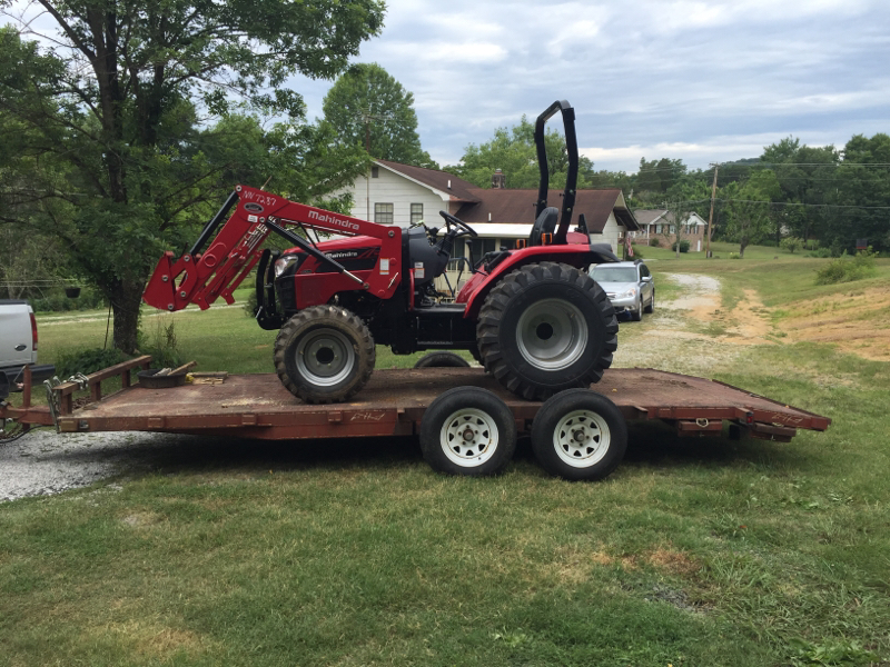

Well the deal is done and the tractor will be delivered tomorrow. I ended up getting a 2540 with R4 tires (loaded rears), loader, a set of pallet forks, and a finish mower. It took me a little longer to decided because I started looking into utility sized tractors as well. I was about to pull the trigger on a NH Workmaster 50 4wd, R4, loader and while test driving it I asked myself what the crap am I going to do with this beast. Personally I believe both of the tractors would do what I wanted I just think the NH would have been just a lot bigger then I needed.

Guess I am going to need a bigger trailer!
