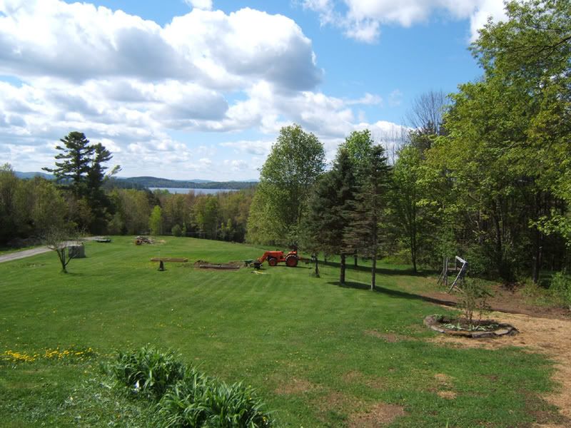

My house is on one end of an old 4 acre pasture, no protruding rocks, somewhat uneven. What is now a pretty decent lawn (1/2 ac?) is just field that has been mowed for 25+ years & the rest I cut about twice a year. Sounds similar to your situation.
I own a sickle bar mower, a rotary cutter & a flail mower & have used all three to cut the same field at different times. The sickle bar is probably from the 70's, the other two I bought new. I almost exclusively use the flail mower these days. I have an L3400 & an 8N.
The sickle bar (7') leaves a nice cut, but is fussy & tended to clog if I didn't get to the mowing before the grass got too thick. But it was great for getting under the edge of the tree line & could cut slightly down the bank if I adjusted it lower. There were also alot of edges to keep sharp.
The rotary (5') cuts without complaint but typically leaves clumps & windrows that were pretty thick. You also had to back in to cut under the tree line, alot of forward & backward unless you didn't mind getting branches in the face & scraping the paint of the tractor. Since it IS so simple I still use it for rougher stuff & don't worry about it, but I don't expect it to look great.
I have found the flail (6') to be best suited to most of what I mow. It leaves a cut that looks almost like our lawn tractor (there are lines from the way the knives are shaped), stuff is totally mulched without any windrows & with the offset I can cut under things to a point (not as well as the sickle bar) without backing in. I also don't worry about flying sticks or rocks (or broken windows, don't ask) I don't cut down large saplings with it but it's not used only for grass. I also find the width a good balance between less passes & maneuverability.
As for maintenance, the sickle bar needed the most attention (needs a bearing right now), the bush hog needs a back corner welded where the housing tore & could use another sharpening & I just replaced 2 shackles on the flail after I put it up on a decent sized rock hidden in some tall weeds in an unfamiliar field. I usually sharpen the RC each season since it's so quick. The flail is in it's third season & I haven't sharpened the knives yet, partly because there are so many but they're also in way better shape than I would have expected. Other than that, no maintenance issues.
This pic is a few years old as there is now a large fenced garden about where the tractor is. I still cut the upper section with the lawn tractor but often cut the lower 60' or so of lawn beyond the garden with the flail as it's faster & it doesn't have to be "real" lawn.
Don't know if that helps or not, good luck!
TD
I meant to add that a neighbor has a higher end RC (a Landpride, I think) that leaves a nice finish on one of the fields he cuts for hire. I drive by there going to work & when he's mowing it looks like a similar ground speed to what I use with the flail.
