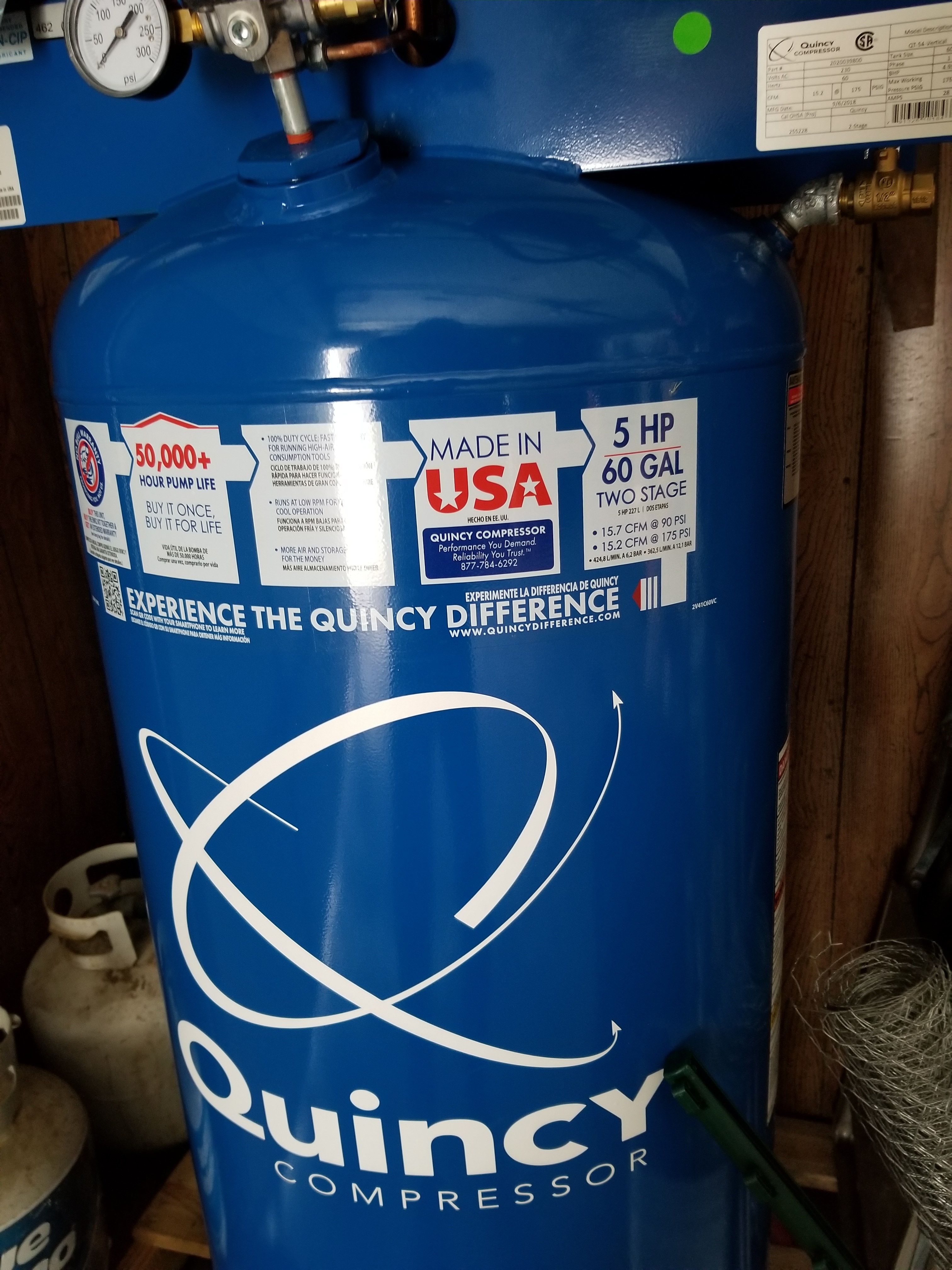

Mine's the 5 hp 2 stage. 15.2 cfm @ 175 psi, 15.7 cfm @ 90 psi.
Got it on sale for just south of $1400
