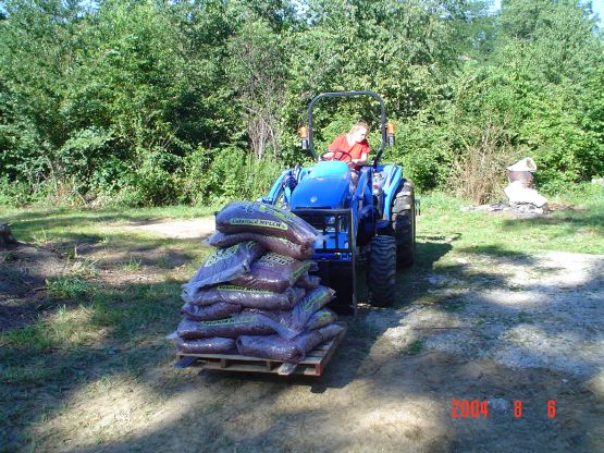

Thanks for the kind compliments. I used it for darn near everything BB, grading, running a snowblower, and pulling a trailer. I bought a NH tc40da because the AC was too hard for my wife to run safely, and she wanted to help with the property clearing (building a house) The NH just did everything soooooo much easier the old allis got stuck pulling a trailer, and thats about it. I pulled it into the shop one fall to just give it a tune up, and well got carried away. It was an old dead fence row tractor so most of the aftermarket stuff was a modern replacement for what was missing. I really enjoyed it and look forward to doing it again in the future as it was a lot of fun and I learned a lot. you would simply not believe how much crud and gunk will accumulate on one of these things after 50 years, Dynamite is a bit of a stretch, but with more bolts broken off than were good, it was a thought a couple times. (BTW I have a lovely collection of factory original bolt heads and vintage bailing wire in a coffee can /forums/images/graemlins/grin.gif)
