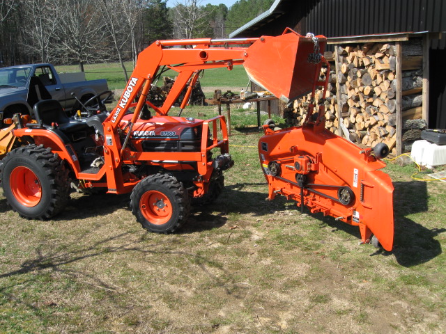

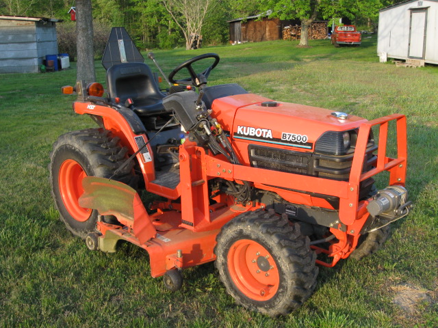

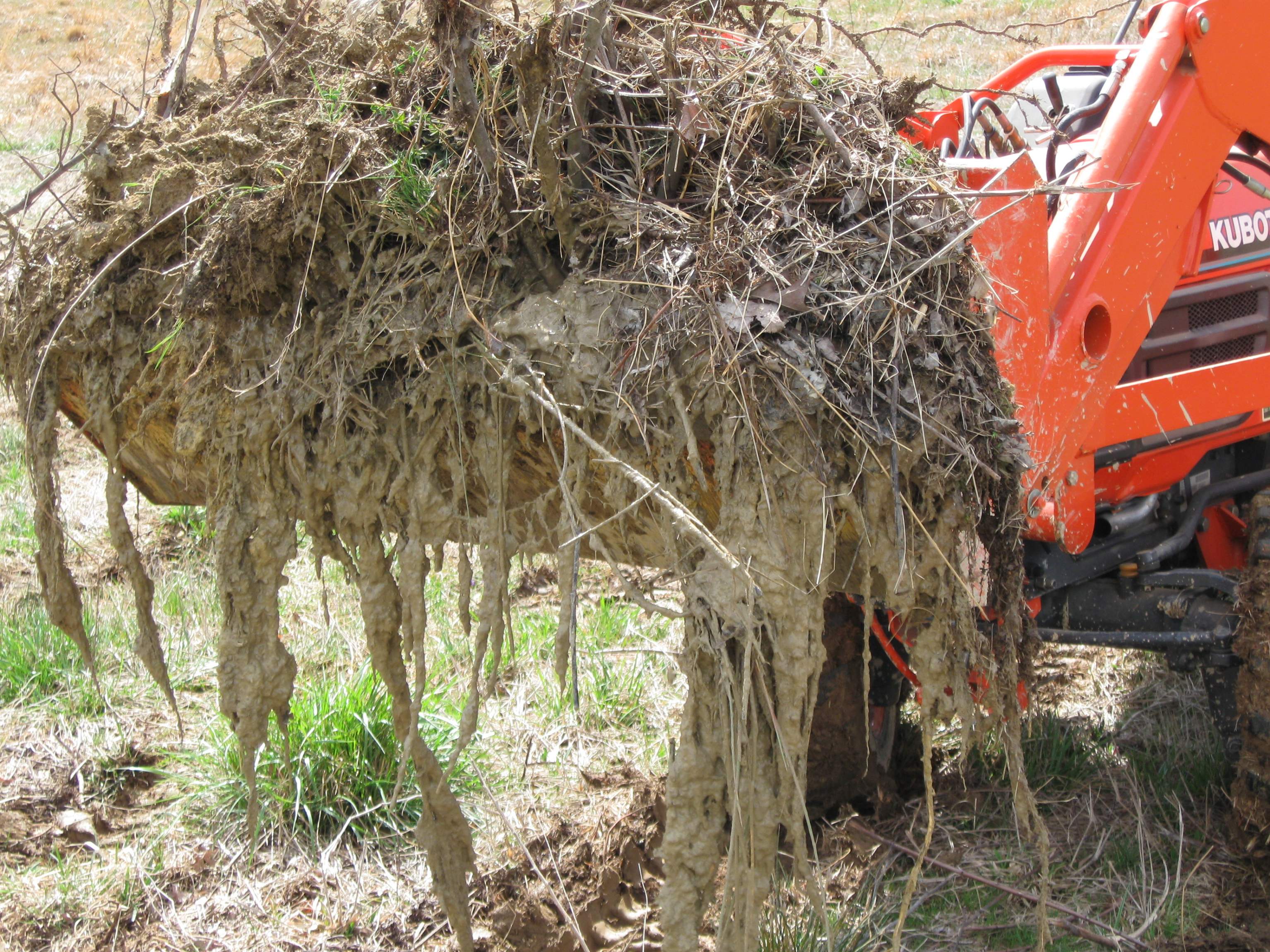

I have a B7500 and love it.It's done everything I've asked it to.Here is some pics.
