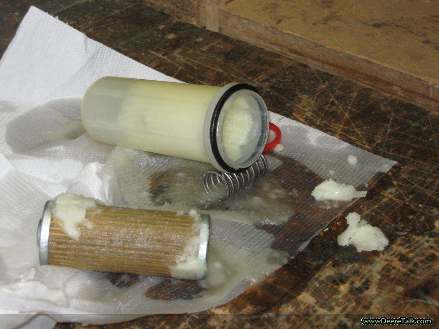

In my area, unless we buy offroad diesel, its all bio-diesel. That pretty much takes care of a lubricity problems. The only problems I've had is two plugged up fuel filters on my Bx in the winter. I never did figure out if it was gelling or dirty fuel, and I cut the filters open. I also work with someone that left his tractor outside with summer fuel in it, and it gelled up big time. Thats the only reason I can think of to add an additive is for gelling.

I had not used additives for 20 years then in 2008 I had this problem...
Now I use this...
