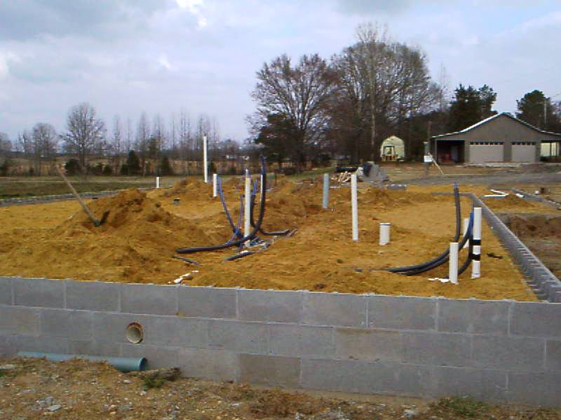

That is how my house and shop were built. Grade beam was poured, then concrete blocks set on the grade beam and these were used for the slab form. Compacted sand was then placed inside the forms for the plumbing to lay in. Everything inside the forms was original compacted native soil. No settlement has occurred in the 8 years we have lived here gary house 030 3_18_10.JPG Our contractor builds everything that way.
Note the black pipe is foam insulation for the water lines. We installed a hot water circulation system to each water station so we have basically instant hot water for sink and shower. The only station that isn't constantly circulated is the kitchen sink and middle bathroom since they are only about 10 feet from the hot water heater. I love this since the master bath is about 50 feet from the hot water but it only takes about 3 seconds to get hot water (distance from slab to faucet).
