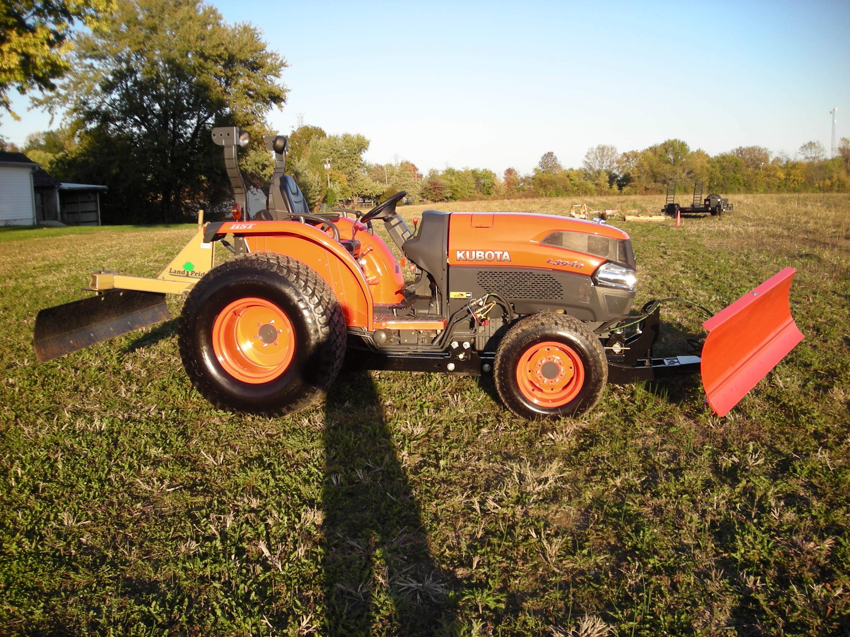

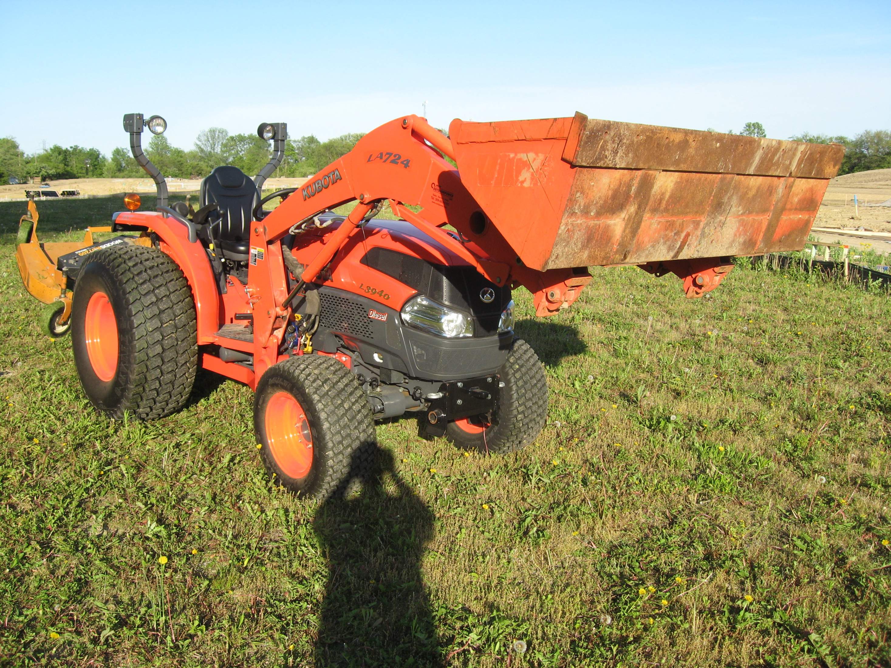

   / Opinions on Kubota L3940 4WD HST with loader. #7
I am very happy with mine. I have alot of implements, but the ones I use most are hydraulic top link, RFM, FEL, front blade, ballast box, box blade, pulverizer, post hole digger. I would get two rear remotes, one for hydraulic top link and one for something else. Research your tire choices. Philip.
