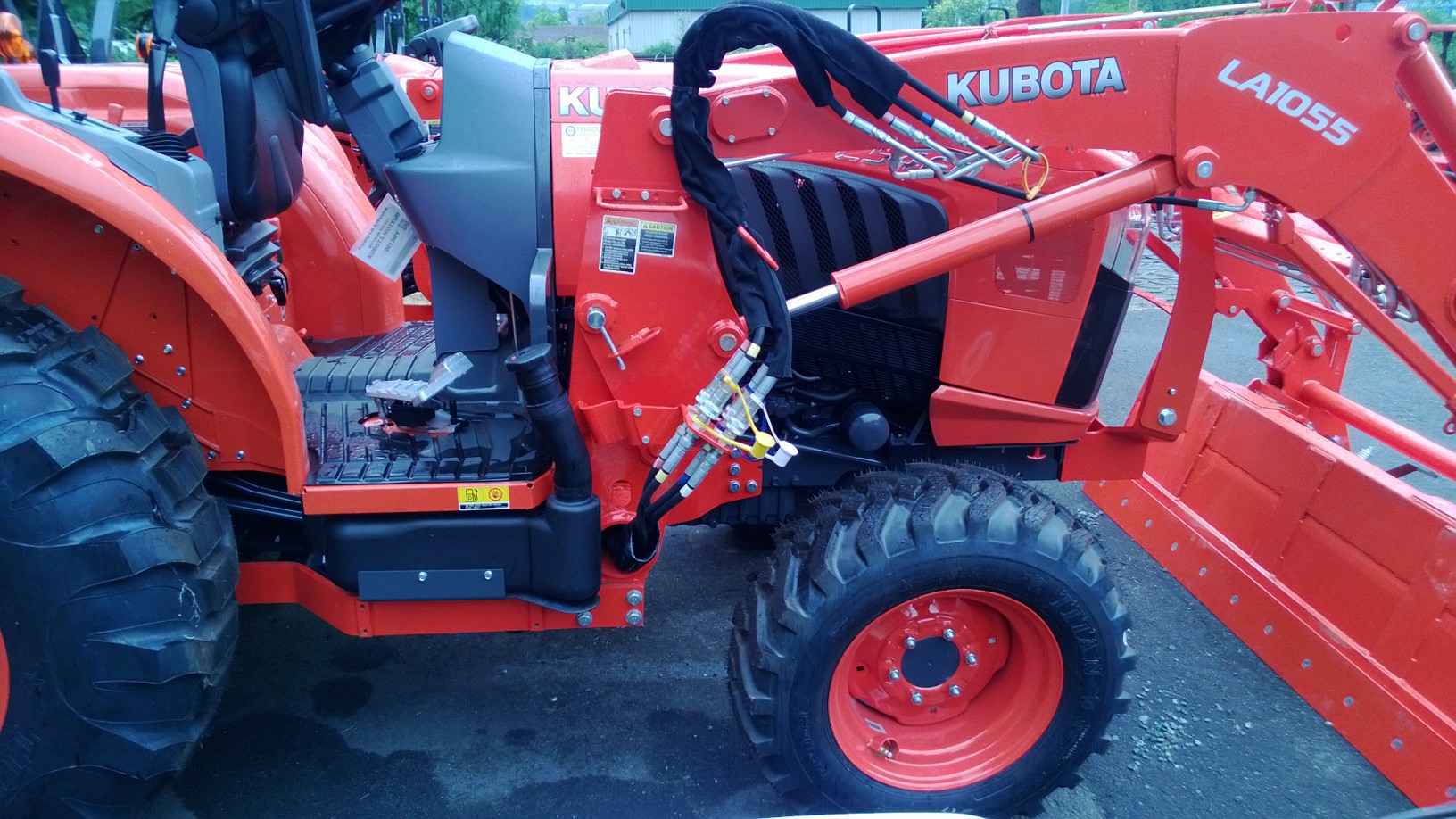

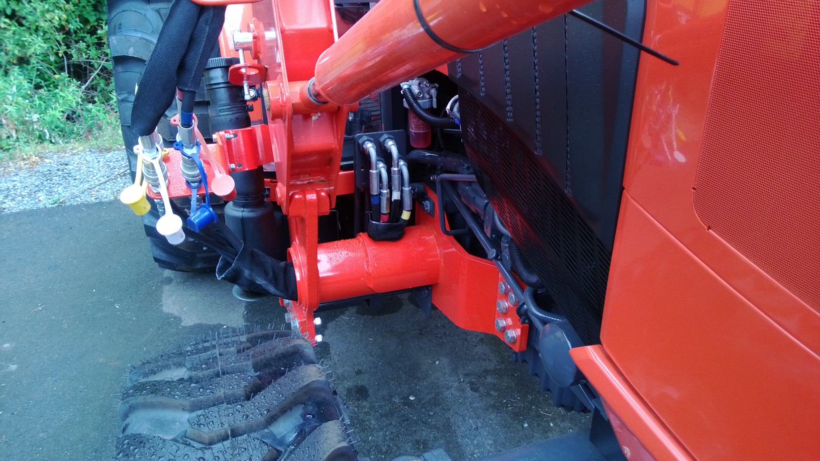

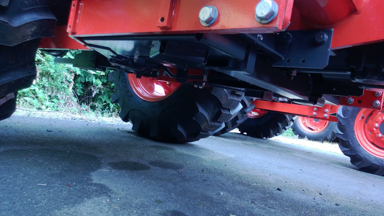

Here's some pics of an l5060 I saw this morning. It doesn't have rear remotes so I can't say where they would be routed.
So although the upper hoses are in the same place as the l4060, notice there are no exposed lines below the tractor that I saw (because of the bigger frame I think) as compared to the l4060.
Just sharing in case of interest to anyone. Please excuse poor images from my new cellphone.

That is a nice tractor but the hose routing is not as clean looking as what it is on the LA854 loader.

Yes, but the problem is something that runs the la854 is no longer available.

I've had no trouble from mine. It does hang out there a bit. I've been through some thick places, had some hard slaps on the mirrors but nothing jumped up and bit me yet. I think it would take something popping up and then the forward momentum of the tractor to really get it good.
The brush or sticks that get you are the ones that are wedged under the tractor from forward momentum, and then a direction change. The tall stuff that reaches the mirrors aren't going to give you much problem.
