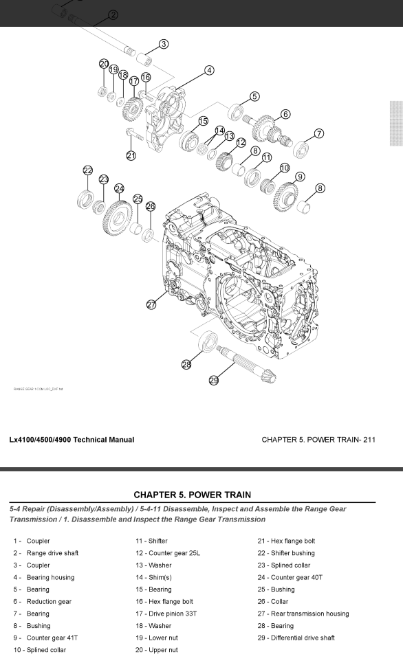

Thank you all for the welcome! I left out that both tractors have HST's. IN my tractor search I had pretty much resigned myself to a tier 4 engine- of the tier 4's, I liked the Mitsubishi in the Massey the best, I figured the only way I would get into a tier 3 was to pick up a used tractor- which I wanted to avoid. Here in 2017 I feel like both were pretty much on even ground, I question the longevity of the MF engine with all of the environmental "extras". I also have the impression that the planetary final drives on the yanmar are a bit more robust?
   / Opinions on "leftover" LX4500 w/ FEL #6
I don't know that there are planetary final drives on the HST Yanmar tractors...

Based on the information I have these Yanmars have a "planetary system" final drive, headed back to the dealers tomorrow for a second look at both tractors and some more seat time!! Thanks for the input!
   / Opinions on "leftover" LX4500 w/ FEL #8
Here is a shot of the HST from our tractors. I don't see any planetary gears in the schematics to the front or rear either.

#9
Jeeze thank you for the diagram- where did you pick the shop manual? I saw a few links but was hesitant to pull the trigger- as I wasn't quite sure if the sites were legit.
