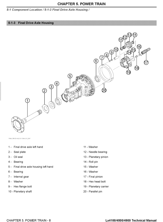

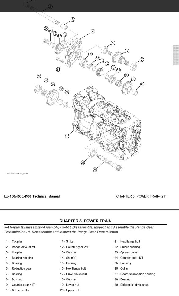

Here is a shot of the HST from our tractors. I don't see any planetary gears in the schematics to the front or rear either.

The final drive planetary gears people refer to are gears that actually drive the rear axles. They are in the axle housing that bolts on to the side of the housing in your parts diagram. The planetary gears are in the bulge right at the interface of the axel housing and the main transmission housing. Planetary gears do a good job of transmitting high torque because inherently the load is on more tooth surface across more tooth root than a given size spur gear, ie more compact than spur gear. More expensive than spur gears but smoother and higher torque capability. Its what bulldozers and heavy earth moving equipment uses. Planetary gears that is.
Thank you for correcting me. I only looked at the dif housing front and rear... there is another section 'final drive', shows the planetary gear. Thanks again.
