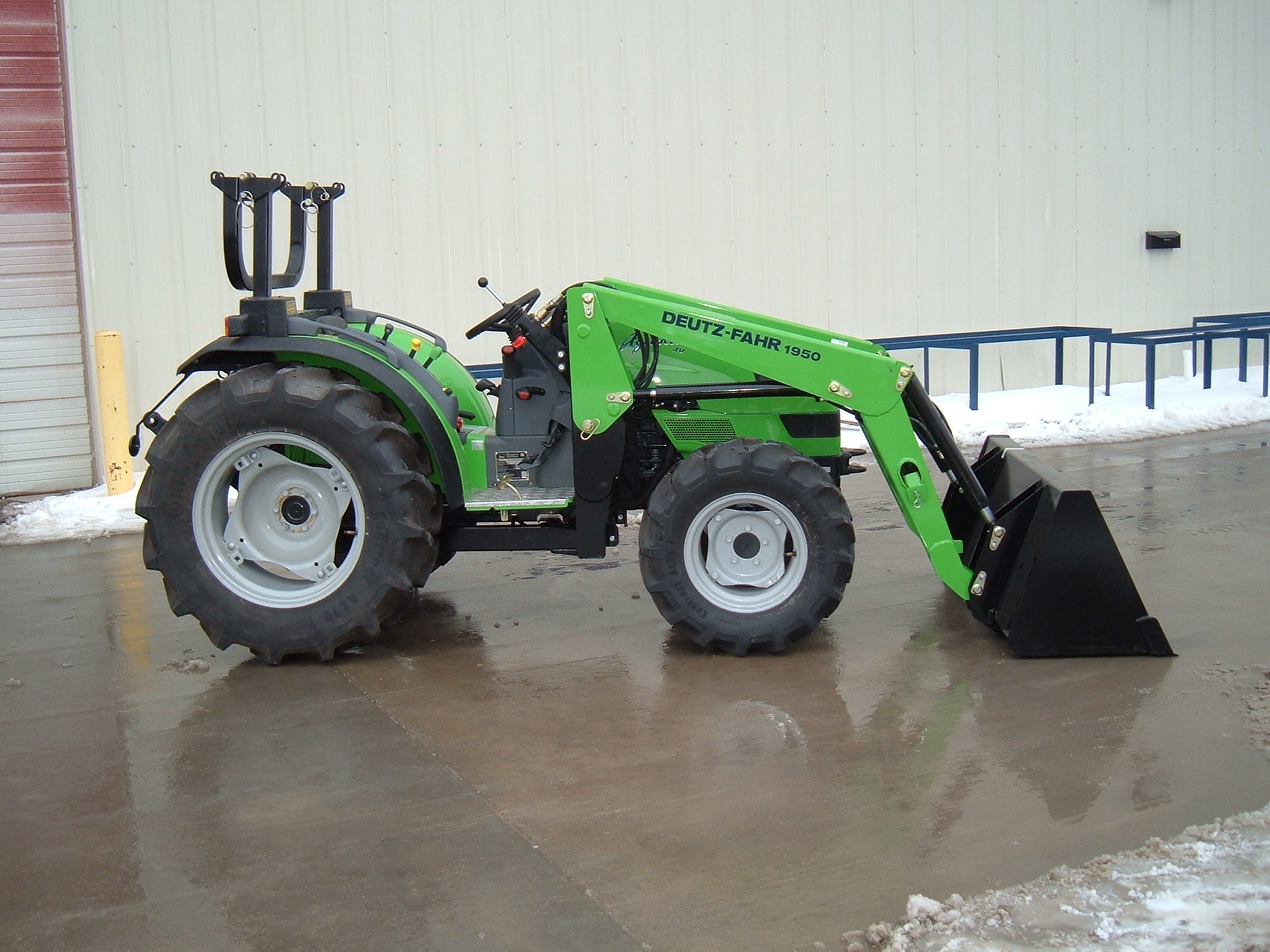

   / Opinions on Loaders, Curved vs Coventional #8
schmism said:
id rather have something that was easyer to manuver than easyer to see.
I'm not sure how hit could be easier to maneuver if you lose visibility, but to some extent I agree with your point.
Here is a reasonably good loader design. Better by a wide margin than the old dogleg style. Maybe this would be a good compromise between a curved loader and a dogleg loader? I think this loader is mounted a little higher than it needs to be, but it has a nice rake to the arms and the bucket is closer to the front wheels than you'd get on a curved arm loader. Still, my strong preference is for a loader that is not over the hood of the tractor any more than necessary. This loader is over the hood for its entire reach, still it is a nice improvement over many of the loaders on the market. Like I said, it looks like a good compromise between curved loaders and the old doglegs.
