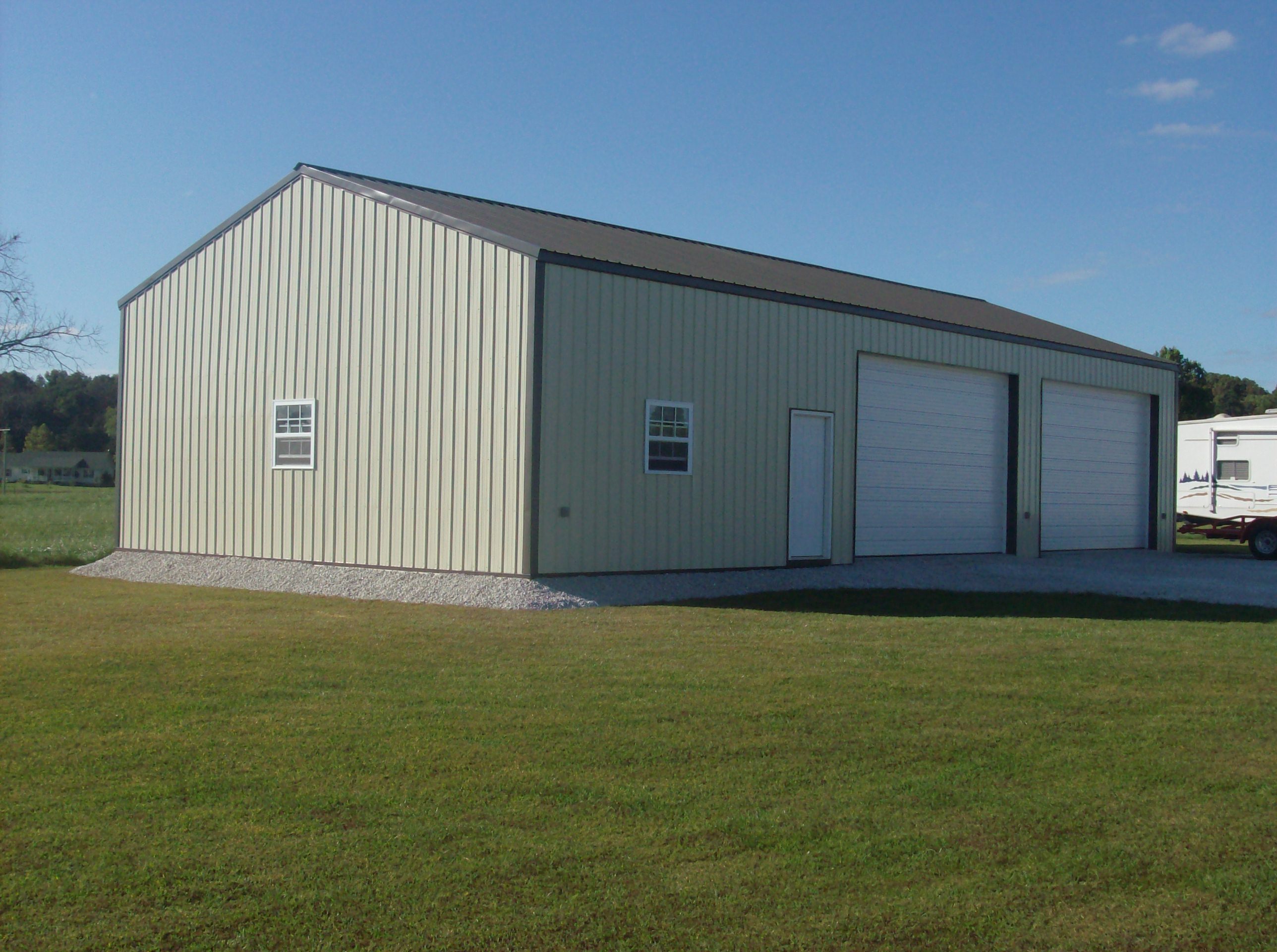

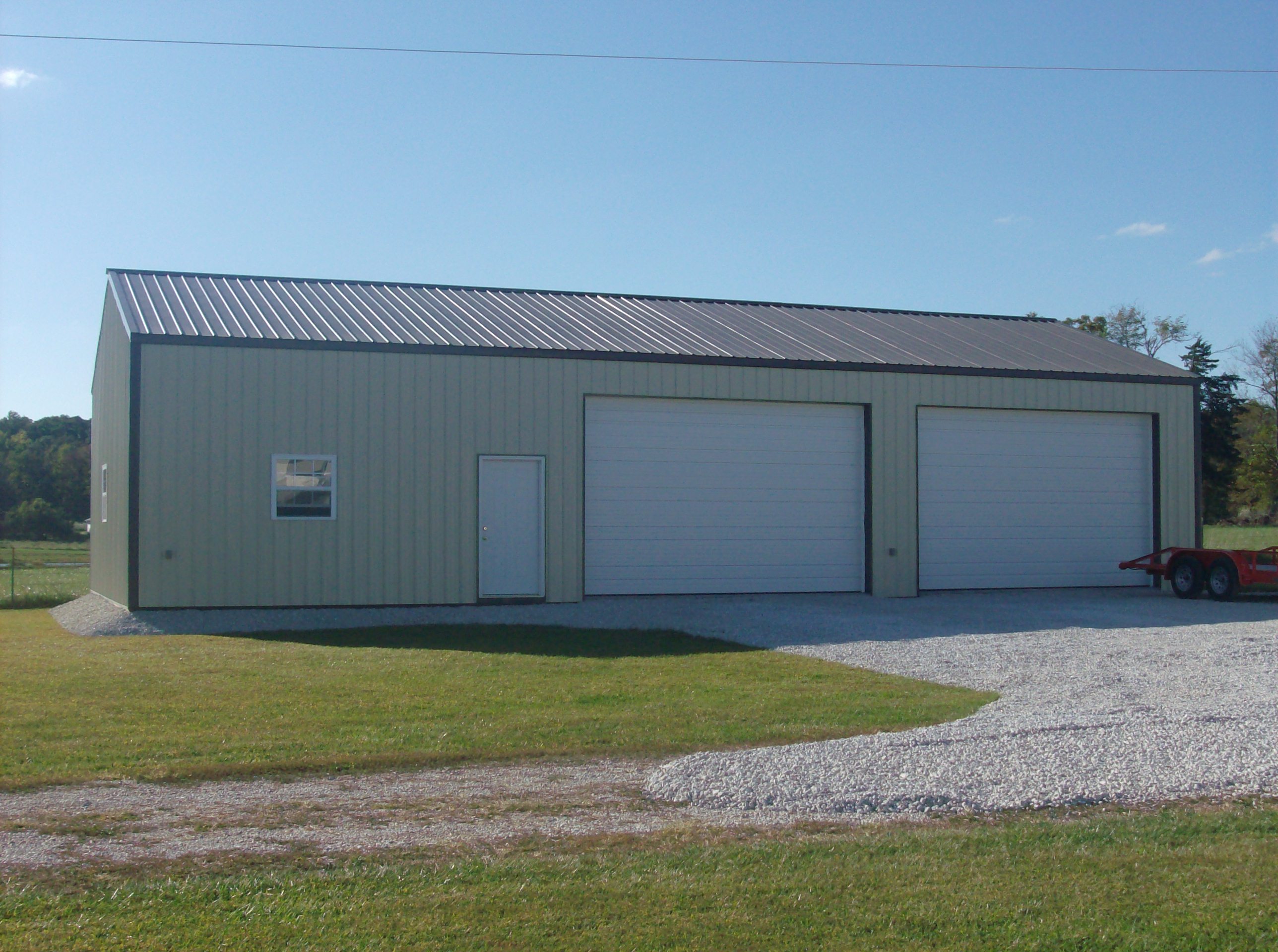

My first barn was 34 x 48 x 10, it came with a house I bought. I had to use my garden tractor to get my boat in there because it was to tall when hitched to a normal vehicle. My motor home had to sit outside and be serviced outside....
12 foot tall should be a minimum, my new barn is 40 x 60 and has 14 foot side walls. I have never heard anyone say "I wish my barn was shorter" but I have heard many people say that they wished their barn was taller. Going up is the cheapest way to get a lot more cubic foot of building for very little money. I plan on building a wood shop area in my barn with a 7 foot ceiling. The area above the shop will be used for storage, and with the 14 foot side walls the storage loft will still have 6'-4" headroom. I am only going to heat and insulate the shop area so the lower ceiling will help keep the heat down where I am rather than having it go up and out my ridge vent.
Doors do yourself a huge favor......
Get good quality insulated roll up doors with good weather strips. Make one of the doors at least 12 foot wide, 14 or 16 is even better and 13 foot high. I would rather have one 12 foot wide door than 3-10 foot wide doors. Backing up a 8 foot wide boat or trailer through a 10 foot wide door is hard enough in broad daylight with a straight approach, but try it on a dark night when it is raining and your mirrors are covered with rain drops and you back window is fogged up and perhaps you aren't lined up perfectly straight with the door and you won't like it very much. You will wish for a 20 foot wide door. I can't stress this enough.
The crew that built my barn used concrete pole barn biscuts in the bottom of the holes. They claim that putting concrete around the poles just holds the moisture against the wood and causes premature rot. They have been building barns for 30 years so I hope they know what they are talking about.
My barn is built with full size 6 x 6 treated poles.
