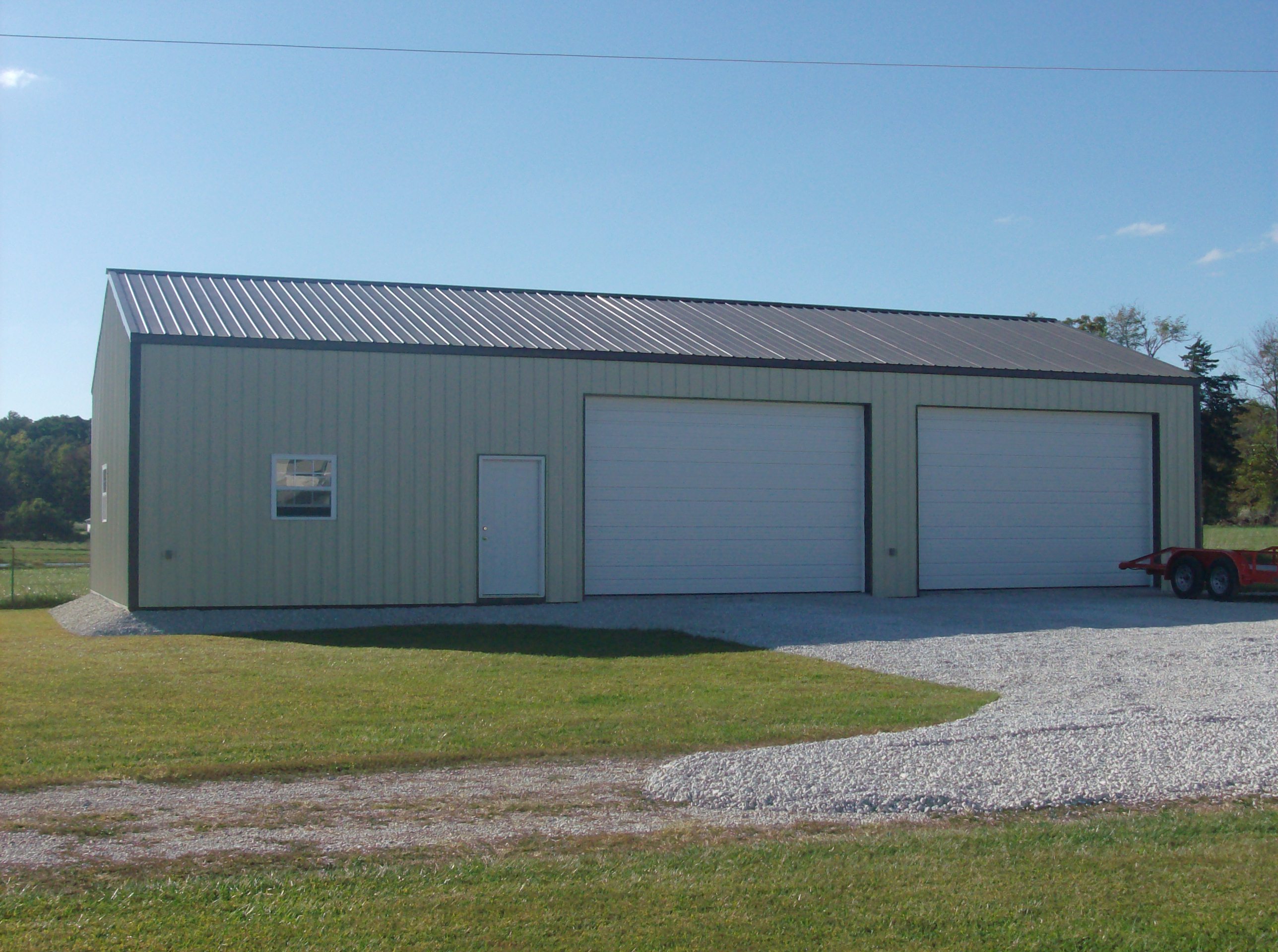

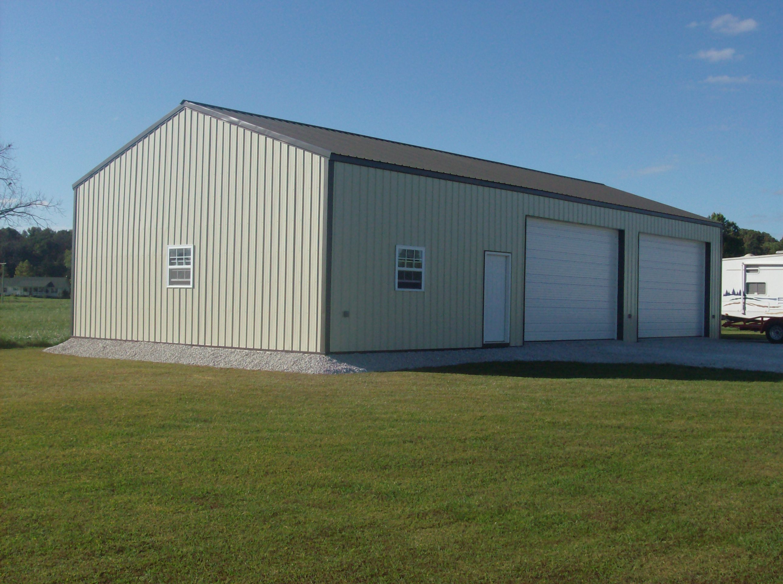

Whatever you do, insulate your barn top and sides. It's a cheap investment and you will enjoy your barn more on a year around basis. Plus, one advantage I noticed right away by insulating my shop was better humidity control. Now my tools and woodworking equipment aren't collecting rust and moisture. It's also easy to heat and cool.
Other than that, like everyone else suggested, height and big entry doors will make life alot easier. My shop is 1 year old this month. It's 30X60 with 12' sidewalls. Doors are 10x16 with one walk in door at a full 36". Total of 3 windows with one at each end to catch the summer breezes.
