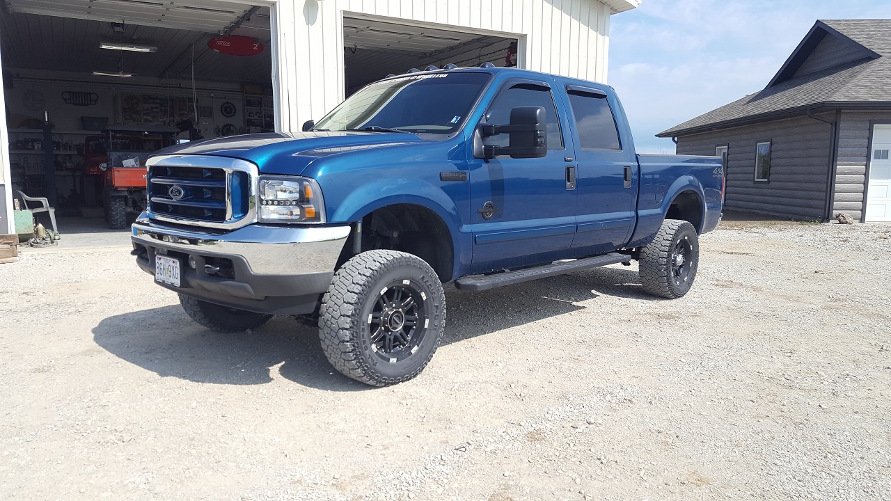

My F350 ('97, crew cab long bed single rear wheel 4x4 manual trans with 4.10:1 gears and 35" tires) is mainly used for towing and hauling, has an unknown amount of miles on the engine (around 250k miles if you believe the previous owner) and over 350k miles on the chassis. It is a '97 but I'm in Oregon so no/minimal rust so it's pretty solid chassis wise. I don't need to be the fastest thing out there, but keeping up with a box stock Duramax would be nice...
It's near stock, 3" exhaust exiting behind the cab (crew cab), round down pipe and no muffler and a round Napa Cummins replacement air filter so minimal restriction there. Manual trans (ZF5) with a warped clutch (I'll run that for now, but will likely need an upgrade with more power). The fuel injectors are showing signs of being worn out so need new ones anyway, from what I've read excessive smoke on startup is one sign of worn injectors. I imagine the turbo might need help since it's not making much boost but could be injector related as well...
The main issue right now is when I'm pulling a long hill (say over a couple miles) the engine starts getting hot when I maintain more than say 5 psi boost at almost any engine speed which normally means going 38 mph up the mountain pass in 3rd gear at 2500 rpm and about 5 psi boost at the A to L in Normal on the gauge (Ford, so no numbers...). This is mainly with over 12,000 pounds combined weight (just recently hauled 15000 lb without a truck bed camper and 18000 lb with a camper over the Santiam Pass at the same speed and temperature). I've changed the fan clutch and belt but not the water pump, radiator is still stock looking copper core unit. I've been hesitating changing the radiator not wanting to go aluminum, might drain and flush it...
Anyway, I'm thinking Full Force 180cc injectors with a Hydra chip with Jellibuilt tunes. A few years ago the HPOP died on me and I located an unknown used one that's been working for a few years but I'd feel better with a rebuilt unit, any recommendations? For what I'm going for I'm thinking about getting the turbo rebuilt with the new style billet wheels, thoughts? I also already have a '01 intercooler but need to make the tubes and mount the thing, even have the '99 intake spider... oh, and I'll be adding a working EGT probe...
I've seen a few 7.3L people around here so I thought this might be a good place to ask, I'm not wanting all out and don't want to go to another forum yet. From what I've read the above plan should do what I want probably plus some but wanted to ask...

As a former owner of 4 different 7.3s, I would suggest you cure your overheating problem before hot rodding anything, because youll only exaggerate the problem if you add more fuel. You overheat that motor and warp the heads and you got problems.
When you say might drain and flush it Im thinking yeah, you might want to do that ? Its cheap and easy. Don稚 forget anti cavitation additive, too.
If it were me, Id be saving the hot rod money on a newer truck with lower miles that goes much faster with no modifications, but thats me.

Do you have a radiator shop by you that can boil it in acid and give it a good cleaning ? Get one of those fail safe t stast that when they get stuck they are open. Is your pressure cap working just replace it cheap insurance. If you wan't out I'll give you 5K in a heart beat.:D
