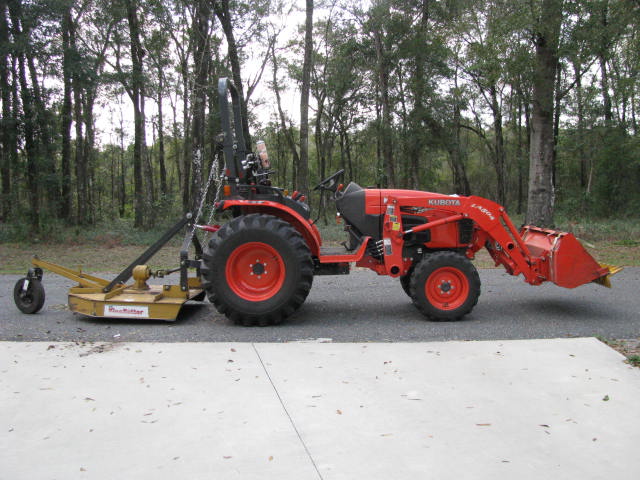

I would ideally like to take my time and work with what I have, which would be the tractor above and a 4ft rotary mower?.Let me know your thoughts.
What's the point of owning a tractor & mower, then rent other eqpt to do its job? All the transport and fees and the time to call around to organize that transaction, then the money too? While your own eqpt is already there, not earning its keep. I like to do a couple acres in the spring and a couple in the fall. I enjoy watching it grow back, and try to do repeat work only on the trouble spots. The more you mow the more you have to mow again. But I only mow for the look, have no good excuse otherwise, you may have other goals.
