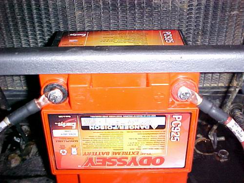

I've had this Odyssey battery in my 33D for 6 years now and never had an issue, it's AGM so bouncing around has little effect and I have had none of the corrosion issues that the factory battery provided. The "L" model puts the terminals on the proper side but I did have to modify the connections.
